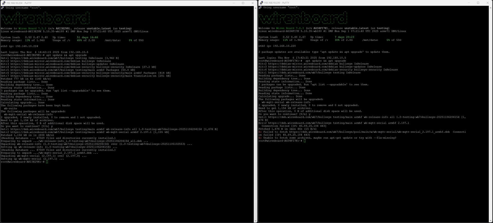

Welcome to Wiren Board 7.4.3 (s/n AG34FI7K), release unstable.latest (as testing)
Linux wirenboard-AG34FI7K 5.10.35-wb180 #1 SMP Mon Sep 1 07:21:40 UTC 2025 armv7l GNU/Linux
System load: 0.63 0.47 0.39 Up time: 2 days 15:07
Memory usage: 13% of 1.96G Usage of /: 48% of 2.0G /mnt/data: 2% of 55G
eth0 ip: 192.168.10.220
Last login: Sun Nov 9 08:04:42 2025 from 192.168.10.5
root@wirenboard-AG34FI7K:~# apt update && apt upgrade
Hit:1 https://deb.wirenboard.com/wb7/bullseye testing InRelease
Hit:2 Index of /debian bullseye InRelease
Hit:3 Index of /debian bullseye-updates InRelease
Err:4 Index of /debian-security bullseye-security InRelease
Connection failed [IP: 52.19.109.145 443]
Reading package lists… Done
All packages are up to date.
W: Failed to fetch http://debian-mirror.wirenboard.com/debian-security/dists/bullseye-security/InRelease Connection failed [IP: 52.19.109.145 443]
W: Some index files failed to download. They have been ignored, or old ones used instead.
Calculating upgrade… Done
0 upgraded, 0 newly installed, 0 to remove and 0 not upgraded.

Welcome to Wiren Board 7.3.3 (s/n AKI3E2VK), release unstable.latest (as testing)
Linux wirenboard-AKI3E2VK 5.10.35-wb180 #1 SMP Mon Sep 1 07:21:40 UTC 2025 armv7l GNU/Linux
System load: 0.18 0.50 0.53 Up time: 54 days 18:13
Memory usage: 14% of 1.96G Usage of /: 48% of 2.0G /mnt/data: 8% of 55G
eth0 ip: 192.168.10.224
Last login: Sun Nov 9 08:05:26 2025 from 192.168.10.5
root@wirenboard-AKI3E2VK:~# apt update && apt upgrade
Hit:4 Index of /debian-security bullseye-security InRelease
1 package can be upgraded. Run ‘apt list --upgradable’ to see it.
The following packages have been kept back:
wb-suite
0 upgraded, 0 newly installed, 0 to remove and 1 not upgraded.
