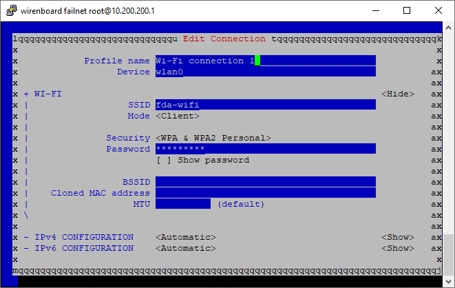

root@wirenboard-AFKNX4WD:~# nmcli connection up "Wi-Fi connection 1"
Error: Connection activation failed: No suitable device found for this connection (device dbg0 not available because profile is not compatible with device (mismatching interface name)).
