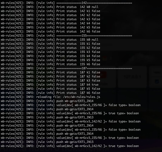

Перестало работать правило, ошибка can't convert control
Очень интересная картина
log("===============142===========================");
log("Print status  142 k0", dev['wb-mr6cv3_142/K0']);
log("Print status  142 k1", dev['wb-mr6cv3_142/K1']);
log("Print status  142 k2", dev['wb-mr6cv3_142/K2']);
log("Print status  142 k3", dev['wb-mr6cv3_142/K3']);
log("Print status  142 k4", dev['wb-mr6cv3_142/K4']);
log("Print status  142 k5", dev['wb-mr6cv3_142/K5']);
log("Print status  142 k6", dev['wb-mr6cv3_142/K6']);
log("===============155===========================");
log("Print status  155 k0", dev['wb-mr6cv3_155/K0']);
log("Print status  155 k1", dev['wb-mr6cv3_155/K1']);
log("Print status  155 k2", dev['wb-mr6cv3_155/K2']);
log("Print status  155 k3", dev['wb-mr6cv3_155/K3']);
log("Print status  155 k4", dev['wb-mr6cv3_155/K4']);
log("Print status  155 k5", dev['wb-mr6cv3_155/K5']);
log("Print status  155 k6", dev['wb-mr6cv3_155/K6']);
log("===============187===========================");
log("Print status  187 k1", dev['wb-mr6c_187/K1']);
log("Print status  187 k2", dev['wb-mr6c_187/K2']);
log("Print status  187 k3", dev['wb-mr6c_187/K3']);
log("Print status  187 k4", dev['wb-mr6c_187/K4']);
log("Print status  187 k5", dev['wb-mr6c_187/K5']);
log("Print status  187 k6", dev['wb-mr6c_187/K6']);
Есть идеи?
