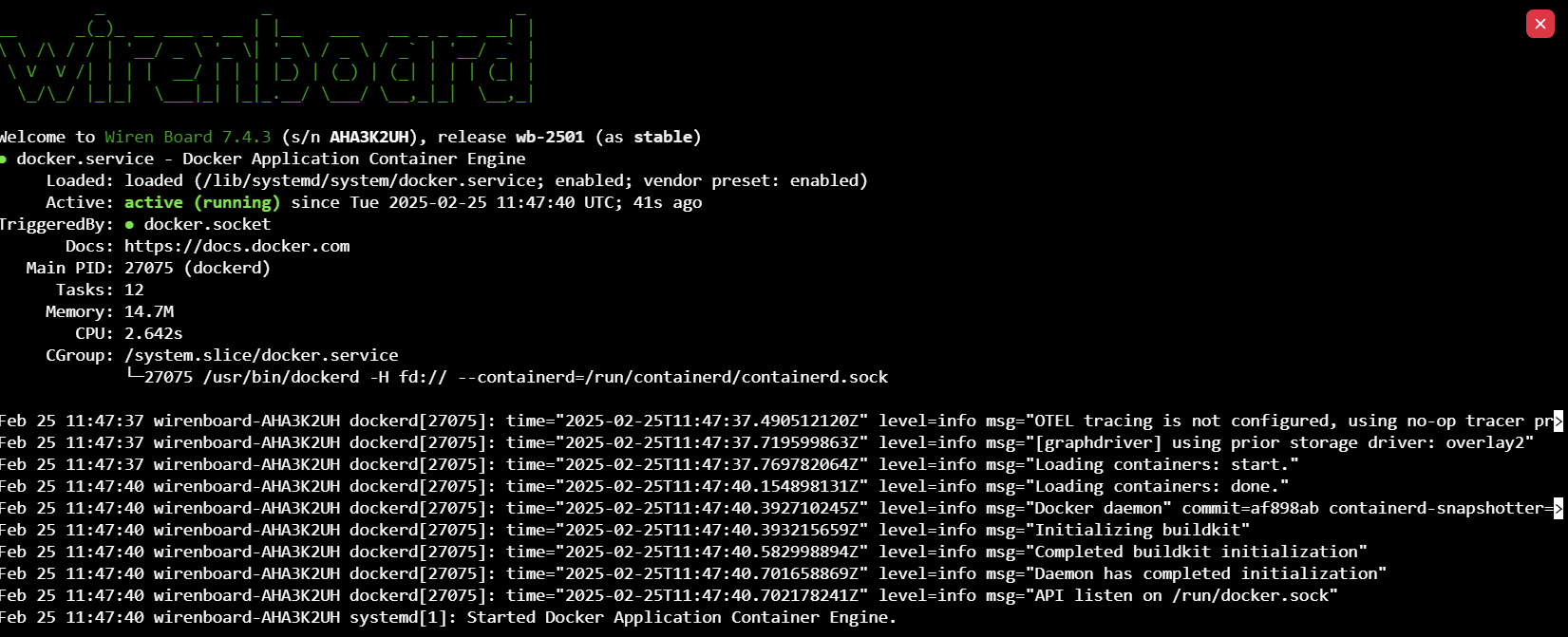

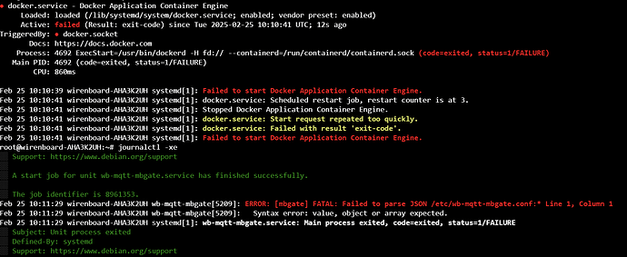

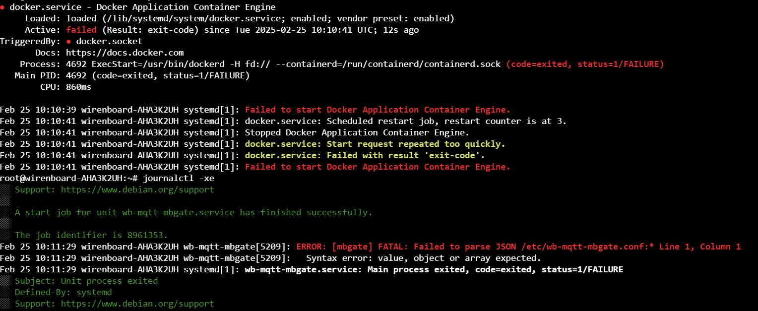

Для диагностики проблемы пришлите архив с диагностической информацией контроллера. Инструкция по созданию архива описана в документации.
Также прошу прислать вывод с консоли в текстовом формате:
systemctl status docker
journalctl -u docker --no-pager --lines=50
root@wirenboard-AHA3K2UH:~# journalctl -u docker --no-pager --lines=50
– Journal begins at Thu 2025-02-20 07:57:23 UTC, ends at Tue 2025-02-25 11:51:08 UTC. –
Feb 25 10:50:09 wirenboard-AHA3K2UH systemd[1]: Stopped Docker Application Container Engine.
Feb 25 10:50:09 wirenboard-AHA3K2UH systemd[1]: docker.service: Consumed 1.007s CPU time.
Feb 25 10:50:10 wirenboard-AHA3K2UH systemd[1]: Starting Docker Application Container Engine…
Feb 25 10:50:10 wirenboard-AHA3K2UH dockerd[27525]: time=“2025-02-25T10:50:10.321786551Z” level=info msg=“Starting up”
Feb 25 10:50:10 wirenboard-AHA3K2UH dockerd[27525]: time=“2025-02-25T10:50:10.329652675Z” level=info msg=“OTEL tracing is not configured, using no-op tracer provider”
Feb 25 10:50:10 wirenboard-AHA3K2UH dockerd[27525]: time=“2025-02-25T10:50:10.692325643Z” level=info msg=“[graphdriver] using prior storage driver: overlay2”
Feb 25 10:50:10 wirenboard-AHA3K2UH dockerd[27525]: time=“2025-02-25T10:50:10.741715461Z” level=info msg=“Loading containers: start.”
Feb 25 10:50:11 wirenboard-AHA3K2UH dockerd[27525]: time=“2025-02-25T10:50:11.009859562Z” level=info msg=“stopping event stream following graceful shutdown” error=“” module=libcontainerd namespace=moby
Feb 25 10:50:11 wirenboard-AHA3K2UH dockerd[27525]: failed to start daemon: Error initializing network controller: error obtaining controller instance: failed to register “bridge” driver: invalid type
Feb 25 10:50:11 wirenboard-AHA3K2UH systemd[1]: docker.service: Main process exited, code=exited, status=1/FAILURE
Feb 25 10:50:11 wirenboard-AHA3K2UH systemd[1]: docker.service: Failed with result ‘exit-code’.
Feb 25 10:50:11 wirenboard-AHA3K2UH systemd[1]: Failed to start Docker Application Container Engine.
Feb 25 10:50:13 wirenboard-AHA3K2UH systemd[1]: docker.service: Scheduled restart job, restart counter is at 3.
Feb 25 10:50:13 wirenboard-AHA3K2UH systemd[1]: Stopped Docker Application Container Engine.
Feb 25 10:50:13 wirenboard-AHA3K2UH systemd[1]: docker.service: Start request repeated too quickly.
Feb 25 10:50:13 wirenboard-AHA3K2UH systemd[1]: docker.service: Failed with result ‘exit-code’.
Feb 25 10:50:13 wirenboard-AHA3K2UH systemd[1]: Failed to start Docker Application Container Engine.

Feb 25 11:47:37 wirenboard-AHA3K2UH systemd[1]: Starting Docker Application Container Engine…
Feb 25 11:47:37 wirenboard-AHA3K2UH dockerd[27075]: time=“2025-02-25T11:47:37.470028767Z” level=info msg=“Starting up”
Feb 25 11:47:37 wirenboard-AHA3K2UH dockerd[27075]: time=“2025-02-25T11:47:37.490512120Z” level=info msg=“OTEL tracing is not configured, using no-op tracer provider”
Feb 25 11:47:37 wirenboard-AHA3K2UH dockerd[27075]: time=“2025-02-25T11:47:37.719599863Z” level=info msg=“[graphdriver] using prior storage driver: overlay2”
Feb 25 11:47:37 wirenboard-AHA3K2UH dockerd[27075]: time=“2025-02-25T11:47:37.769782064Z” level=info msg=“Loading containers: start.”
Feb 25 11:47:40 wirenboard-AHA3K2UH dockerd[27075]: time=“2025-02-25T11:47:40.154898131Z” level=info msg=“Loading containers: done.”
Feb 25 11:47:40 wirenboard-AHA3K2UH dockerd[27075]: time=“2025-02-25T11:47:40.392710245Z” level=info msg=“Docker daemon” commit=af898ab containerd-snapshotter=false storage-driver=overlay2 version=28.0.0
Feb 25 11:47:40 wirenboard-AHA3K2UH dockerd[27075]: time=“2025-02-25T11:47:40.393215659Z” level=info msg=“Initializing buildkit”
Feb 25 11:47:40 wirenboard-AHA3K2UH dockerd[27075]: time=“2025-02-25T11:47:40.582998894Z” level=info msg=“Completed buildkit initialization”
Feb 25 11:47:40 wirenboard-AHA3K2UH dockerd[27075]: time=“2025-02-25T11:47:40.701658869Z” level=info msg=“Daemon has completed initialization”
Feb 25 11:47:40 wirenboard-AHA3K2UH dockerd[27075]: time=“2025-02-25T11:47:40.702178241Z” level=info msg=“API listen on /run/docker.sock”
Feb 25 11:47:40 wirenboard-AHA3K2UH systemd[1]: Started Docker Application Container Engine.
Отлично, рад, что всё заработало! Если возникнут вопросы, пишите.
