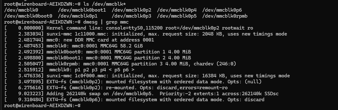

Выполните следующие команды, чтобы проверить наличие и состояние карты памяти:
ls /dev/mmcblk*
dmesg | grep mmc
Вывод должен быть похож на пример, представленный на скриншоте.

[ 44.159892] mmcblk0: error -110 transferring data, sector 62680, nr 8, cmd response 0x900, card status 0xb00
[ 44.169843] mmc0: tried to reset card
[ 44.173530] mmcblk0: retrying using single block read
[ 51.002549] mmcblk0: error -110 transferring data, sector 62424, nr 8, cmd response 0x900, card status 0xb00
[ 51.012484] mmc0: tried to reset card
[ 51.016167] mmcblk0: retrying using single block read
[ 57.826480] mmcblk0: error -110 transferring data, sector 62624, nr 8, cmd response 0x900, card status 0xb00
[ 57.836410] mmc0: tried to reset card
[ 57.840153] mmcblk0: retrying using single block read
[ 64.650853] mmcblk0: error -110 transferring data, sector 62432, nr 8, cmd response 0x900, card status 0xb00
[ 64.660788] mmc0: tried to reset card
[ 64.664472] mmcblk0: retrying using single block read
[ 71.475196] mmcblk0: error -110 transferring data, sector 62288, nr 8, cmd response 0x900, card status 0xb00
[ 71.485129] mmc0: tried to reset card
[ 71.488868] mmcblk0: retrying using single block read
[ 78.299559] mmcblk0: error -110 transferring data, sector 62096, nr 8, cmd response 0x900, card status 0xb00
[ 78.309494] mmc0: tried to reset card
[ 78.313181] mmcblk0: retrying using single block read
[ 85.123906] mmcblk0: error -110 transferring data, sector 62008, nr 8, cmd response 0x900, card status 0xb00
[ 85.133842] mmc0: tried to reset card
[ 85.137529] mmcblk0: retrying using single block read
[ 91.948283] mmcblk0: error -110 transferring data, sector 61952, nr 8, cmd response 0x900, card status 0xb00
[ 91.958218] mmc0: tried to reset card
[ 91.961904] mmcblk0: retrying using single block read
[ 98.772649] mmcblk0: error -110 transferring data, sector 61776, nr 8, cmd response 0x900, card status 0xb00
[ 98.782585] mmc0: tried to reset card
[ 98.786268] mmcblk0: retrying using single block read
[ 105.596990] mmcblk0: error -110 transferring data, sector 61712, nr 8, cmd response 0x900, card status 0xb00
[ 105.606925] mmc0: tried to reset card
[ 105.610671] mmcblk0: retrying using single block read
[ 112.421406] mmcblk0: error -110 transferring data, sector 61696, nr 8, cmd response 0x900, card status 0xb00
[ 112.431342] mmc0: tried to reset card
[ 112.435027] mmcblk0: retrying using single block read
[ 119.245572] mmcblk0: error -110 transferring data, sector 61736, nr 8, cmd response 0x900, card status 0xb00
[ 119.255504] mmc0: tried to reset card
[ 119.259248] mmcblk0: retrying using single block read
[ 126.069918] mmcblk0: error -110 transferring data, sector 59600, nr 8, cmd response 0x900, card status 0xb00
[ 126.079858] mmc0: tried to reset card
[ 126.083546] mmcblk0: retrying using single block read
[ 132.894670] mmcblk0: error -110 transferring data, sector 96, nr 128, cmd response 0x900, card status 0xb00
[ 132.904516] mmc0: tried to reset card
[ 132.908259] mmcblk0: retrying using single block read
[ 139.767808] mmcblk0: error -110 transferring data, sector 256, nr 8, cmd response 0x900, card status 0xb00
[ 139.777498] mmc0: tried to reset card
[ 139.781241] mmcblk0: retrying using single block read
[ 146.592136] mmcblk0: error -110 transferring data, sector 512, nr 8, cmd response 0x900, card status 0xb00
[ 146.601898] mmc0: tried to reset card
[ 146.605580] mmcblk0: retrying using single block read
[ 153.416463] mmcblk0: error -110 transferring data, sector 1024, nr 8, cmd response 0x900, card status 0xb00
[ 153.426320] mmc0: tried to reset card
[ 153.430072] mmcblk0: retrying using single block read
[ 160.240864] mmcblk0: error -110 transferring data, sector 2048, nr 8, cmd response 0x900, card status 0xb00
[ 160.250713] mmc0: tried to reset card
[ 160.254397] mmcblk0: retrying using single block read
[ 167.065175] mmcblk0: error -110 transferring data, sector 4096, nr 8, cmd response 0x900, card status 0xb00
[ 167.075041] mmc0: tried to reset card
[ 167.078794] mmcblk0: retrying using single block read
[ 173.889531] mmcblk0: error -110 transferring data, sector 8192, nr 8, cmd response 0x900, card status 0xb00
[ 173.899384] mmc0: tried to reset card
[ 173.903070] mmcblk0: retrying using single block read
[ 180.748843] mmcblk0: error -110 transferring data, sector 224, nr 32, cmd response 0x900, card status 0xb00
[ 180.758700] mmc0: tried to reset card
[ 180.762387] mmcblk0: retrying using single block read
[ 187.574177] mmcblk0: error -110 transferring data, sector 264, nr 216, cmd response 0x900, card status 0xb00
[ 187.584115] mmc0: tried to reset card
[ 187.587859] mmcblk0: retrying using single block read
[ 194.474491] mmcblk0: error -110 transferring data, sector 480, nr 32, cmd response 0x900, card status 0xb00
[ 194.484346] mmc0: tried to reset card
[ 194.488094] mmcblk0: retrying using single block read
[ 201.299890] mmcblk0: error -110 transferring data, sector 520, nr 216, cmd response 0x900, card status 0xb00
[ 201.309824] mmc0: tried to reset card
[ 201.313509] mmcblk0: retrying using single block read
[ 208.200702] mmcblk0: error -110 transferring data, sector 736, nr 256, cmd response 0x900, card status 0xb00
[ 208.210636] mmc0: tried to reset card
[ 208.214319] mmcblk0: retrying using single block read
Пока всё, чего смог добиться. Куда дальше - в морг или ещё есть надежда?
К сожалению, карта неисправна, и ничего с ней сделать нельзя.
