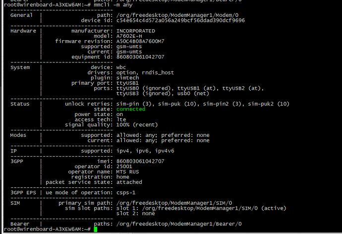

mmcli -m any выдает статус connected. Но выдача IP от оператора не происходит. Пытается бесконечно подключиться. Хотя тут же, эту же симку используешь в телефоне или USB-модеме - подключается отлично.

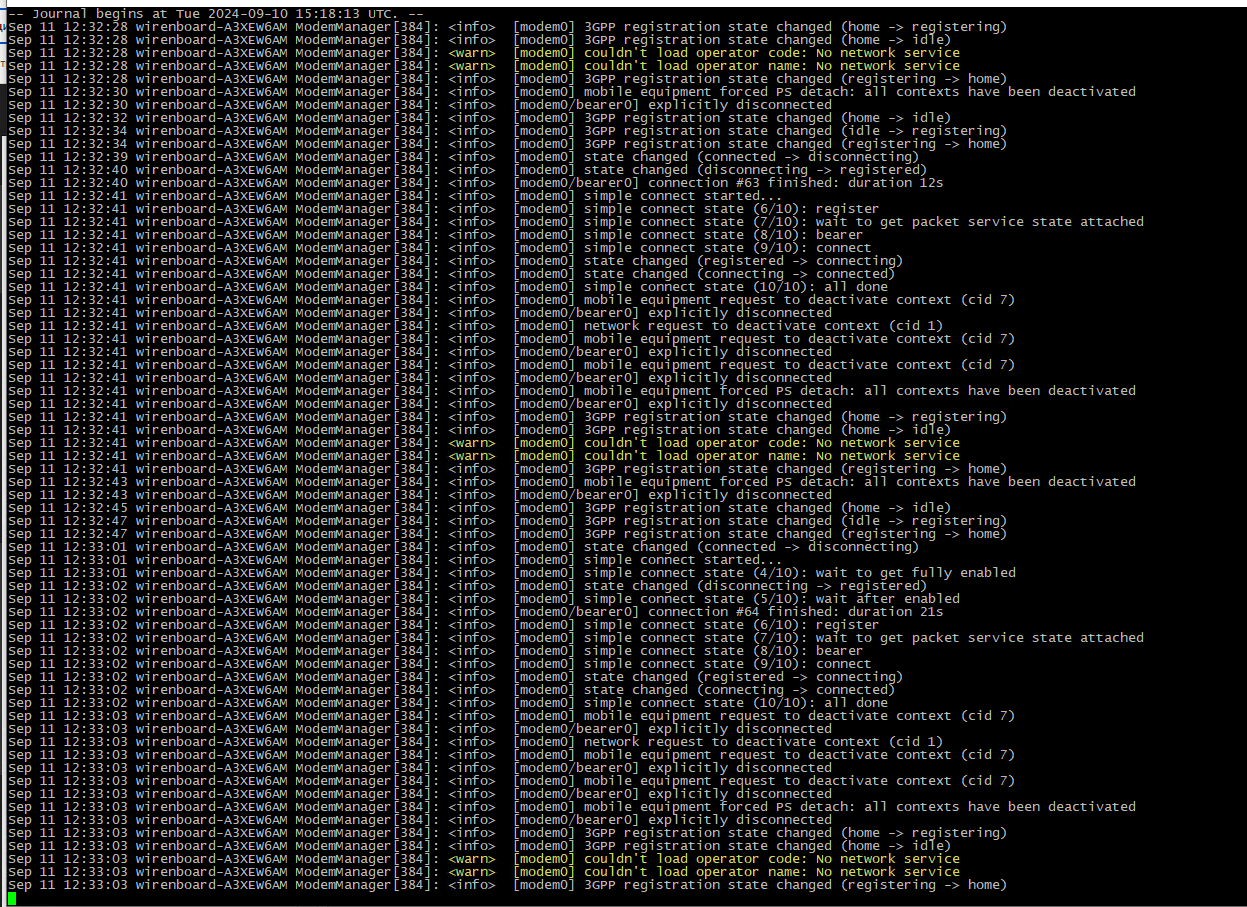

Судя по логам - видно что
2024-09-11T06:19:15.540Z [ModemManager] <info> [modem0] mobile equipment request to deactivate context (cid 7)
2024-09-11T06:19:15.029Z [ModemManager] <info> [modem0] simple connect state (10/10): all done
2024-09-11T06:19:15.027Z [ModemManager] <info> [modem0] state changed (connecting -> connected)
2024-09-11T06:19:14.972Z [ModemManager] <info> [modem0] state changed (registered -> connecting)
2024-09-11T06:19:14.971Z [ModemManager] <info> [modem0] simple connect state (9/10): connect
2024-09-11T06:19:14.970Z [ModemManager] <info> [modem0] simple connect state (8/10): bearer
2024-09-11T06:19:14.970Z [ModemManager] <info> [modem0] simple connect state (7/10): wait to get packet service state attached
2024-09-11T06:19:14.969Z [ModemManager] <info> [modem0] simple connect state (6/10): register
2024-09-11T06:19:14.966Z [ModemManager] <info> [modem0] simple connect started...
2024-09-11T06:18:33.667Z [ModemManager] <info> [modem0/bearer0] connection #31 finished: duration 21s
2024-09-11T06:18:33.663Z [ModemManager] <info> [modem0] state changed (disconnecting -> registered)
2024-09-11T06:18:32.593Z [ModemManager] <info> [modem0] state changed (connected -> disconnecting)
2024-09-11T06:18:14.539Z [ModemManager] <info> [modem0] 3GPP registration state changed (registering -> home)
2024-09-11T06:18:14.454Z [ModemManager] <info> [modem0] 3GPP registration state changed (idle -> registering)
2024-09-11T06:18:13.535Z [ModemManager] <info> [modem0] 3GPP registration state changed (home -> idle)
2024-09-11T06:18:12.701Z [ModemManager] <info> [modem0] 3GPP registration state changed (registering -> home)
2024-09-11T06:18:12.700Z [ModemManager] <warn> [modem0] couldn't load operator name: No network service
2024-09-11T06:18:12.670Z [ModemManager] <warn> [modem0] couldn't load operator code: No network service
2024-09-11T06:18:12.653Z [ModemManager] <info> [modem0] 3GPP registration state changed (home -> idle)
2024-09-11T06:18:12.640Z [ModemManager] <info> [modem0] 3GPP registration state changed (home -> registering)
в несколько попыток, что может говорить или о перегруженной сети или о критически недостаточном уровне сигнала проходит регистрация, затем уже соединение - и оно разрывается по инициативе оператора.

Пытается соединиться. уровень сигнала 100%. Сим-карта в телефоне или в usb-модеме в том же месте работает. Здесь следующее:
journalctl -u ModemManager -f
mmcli -m any
Напомню, это В данный момент пытается подключиться WB7.4.1 wb-2407 stable.
APN прописан верный, симки из одной партии, настройки идентичны с другим ПЛК, на котором все работает.

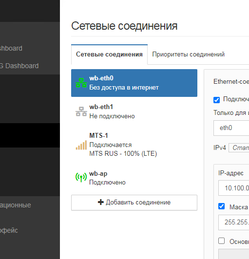

“симка” - не является соединением. Статус соединения и так отражается в панели, топик network/GPRS IP Online Status
