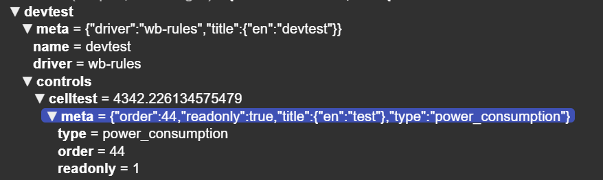

Да, что-то мне знакомым показалось, 1.7976931348623157e+308 ~ Number.MAX_VALUE
При этом:
//02_19_test_01.js
var devtest = 'devtest'
var celltest = {"order":44,"value":4342.226134575478567,"title":"test","type":"range","description":"","units":"","max":1.7e+308,"min":-1.79,"precision":0.000001,"readonly":true,"error":""}
			defineVirtualDevice(devtest, {
				title: devtest,
				cells: {celltest:celltest},
for (var key in celltest) {
  if (celltest.hasOwnProperty(key)) {
    log.info("Имя: " + key + ", Значение: " + celltest[key]);
публикует
/devices/devtest/meta/driver wb-rules
/devices/devtest/meta/name devtest
/devices/devtest/meta {"driver":"wb-rules","title":{"en":"devtest"}}
/devices/devtest/controls/celltest/meta/min -1.79
/devices/devtest/controls/celltest/meta/order 44
/devices/devtest/controls/celltest/meta/readonly 1
/devices/devtest/controls/celltest/meta/type range
/devices/devtest/controls/celltest/meta/max 170000000000000000000000000000000000000000000000000000000000000000000000000000000000000000000000000000000000000000000000000000000000000000000000000000000000000000000000000000000000000000000000000000000000000000000000000000000000000000000000000000000000000000000000000000000000000000000000000000000000000000000
/devices/devtest/controls/celltest/meta {"max":1.7e+308,"min":-1.79,"order":44,"precision":0.000001,"readonly":true,"title":{"en":"test"},"type":"range"}
/devices/devtest/controls/celltest 4342.226135

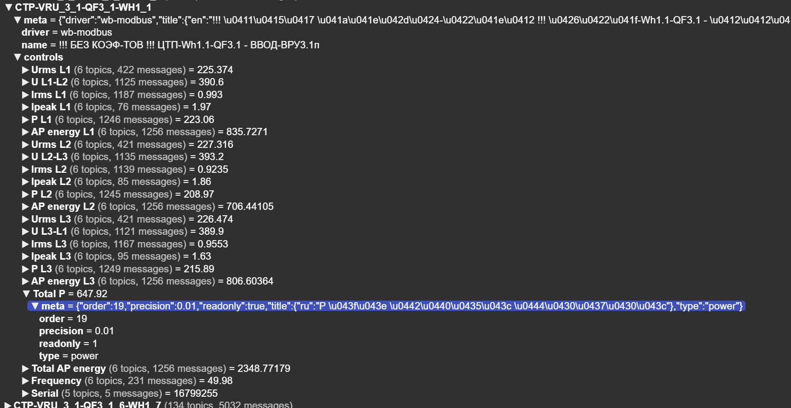

делаю полные виртуальные клоны счетчиков с добавлением коэффициентов от трансформаторов тока, а оно вот клонируется, но не всё ((
var dvID="CTP-VRU_3_1-QF3_1-WH1_1"
var ctrlName="Total P"
  var dv= getDevice(dvID)
  var dvctrl = dv.getControl(ctrlName)
  var cell = {}
  cell.type =  dvctrl.getType()
  cell.title =  { en: dvctrl.getTitle(), ru: dvctrl.getTitle('ru') }
  cell.description =  dvctrl.getDescription()
  cell.units =  dvctrl.getUnits()
  cell.max =  dvctrl.getMax()
  cell.min =  dvctrl.getMin()
  cell.precision =  dvctrl.getPrecision()
  cell.value =  dvctrl.getValue()
  cell.order =  dvctrl.getOrder()
  cell.readonly =  dvctrl.getReadonly()
  cell.error = dvctrl.getError()
log (JSON.stringify(cell))
				title: devtest,
				cells: {celltest:cell},

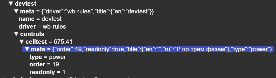

тут dvID это реальный счетчик MAP3E
cell выдал в лог вот такое
{"type":"power","title":{"en":"","ru":"P по трем фазам"},"description":"","units":"","max":1.7976931348623157e+308,"min":-1.7976931348623157e+308,"precision":0.01,"value":675.41,"order":19,"readonly":true,"error":""}
в итоге devtest получился без precision/max/min

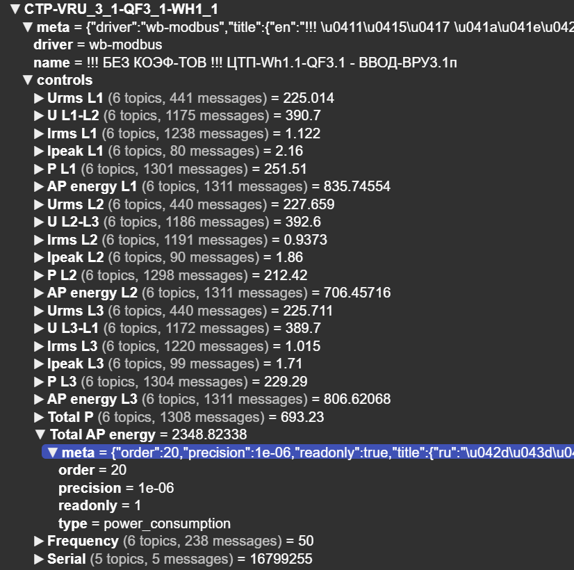

точность такая берется с Total AP energy

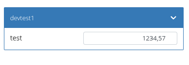

я правильно понял, что у вас нормально опубликовался precision/max/min?
min в вашем примере не такой, как в моем
может mqtt explorer не все отображать?
как мне проверить по-другому?
почему может у меня не публиковаться?

И тема с precision так и не раскрыта. Почему при явном задании этого значения, оно не было применено и не появилось в meta. Даже warning никакого не выдает.
И при чем тут деление на 0,1
Если оно неопеределено, то как и описано - дефолное для типа контрола.

Указываю
"precision":0.01
Получаю
"precision":0.0001

Установка округления работает.

если meta-поле неопределено, то и результат должен быть неопределенным.
вопрос был совсем не про это. Вопрос был про то, что я пытаюсь задать значение meta-поля precision с помощью setPrecision(getPrecision(device_control)), а оно не применяется
