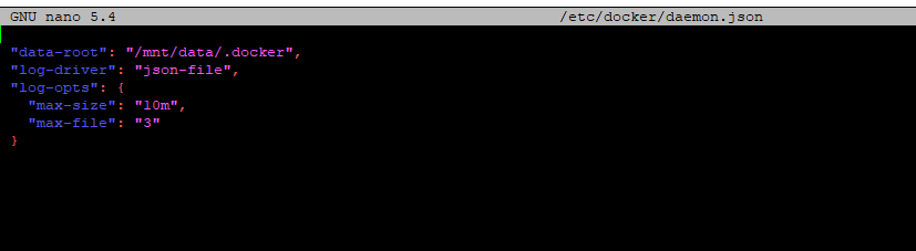

Подскажите пожалуйста какой конкретно пункт я не выполнил? я не понимаю. Шел по всем инструкциям шаг за шагом.
В файле /etc/docker/daemon.json значение data-root должно быть /mnt/data/.docker
Данные строки там прописаны

Docker Root Dir: /mnt/data/.docker
root@wirenboard-AL7Y53UV:~#
root@wirenboard-AL7Y53UV:~# systemctl stop docker
Warning: Stopping docker.service, but it can still be activated by:
docker.socket
root@wirenboard-AL7Y53UV:~# df -h
Filesystem Size Used Avail Use% Mounted on
/dev/root 2.0G 1.2G 661M 64% /
devtmpfs 2.0G 0 2.0G 0% /dev
tmpfs 2.0G 4.0K 2.0G 1% /dev/shm
tmpfs 787M 1.4M 786M 1% /run
tmpfs 5.0M 0 5.0M 0% /run/lock
/dev/mmcblk0p6 55G 511M 52G 1% /mnt/data
tmpfs 394M 0 394M 0% /run/user/0
root@wirenboard-AL7Y53UV:~# du -sh /*
0 /bin
15M /boot
4.0K /chroot_this.sh
4.0K /dev
5.3M /etc
4.0K /home
0 /lib
4.0K /media
du: cannot read directory ‘/mnt/sdcard’: No such device
511M /mnt
16K /opt
du: cannot access ‘/proc/30688/task/30688/fd/4’: No such file or directory
du: cannot access ‘/proc/30688/task/30688/fdinfo/4’: No such file or directory
du: cannot access ‘/proc/30688/fd/4’: No such file or directory
du: cannot access ‘/proc/30688/fdinfo/4’: No such file or directory
0 /proc
0 /root
16K /root.default
1.4M /run
0 /sbin
4.0K /srv
0 /sys
60K /tmp
4.0K /umount_chroot.sh
1.1G /usr
80M /var
Перезапустите сервис containerd, если ещё не перезапускали.
root@wirenboard-AL7Y53UV:~# systemctl stop containerd
root@wirenboard-AL7Y53UV:~# rm -rf /var/lib/containerd/
root@wirenboard-AL7Y53UV:~# systemctl daemon-reload
root@wirenboard-AL7Y53UV:~# systemctl start containerd
root@wirenboard-AL7Y53UV:~# docker compose up -d
[+] Running 26/29
⠇ homeassistant [⣿⣿⣿⣿⣿⣿⣿⣿⣿⣿⣿⣿⣿⣿⣿⣿⣿⣿⣿⣿⣿⣿⣤⣿⣿⣿⣿⣿] Pulling 43.9s
:heavy_check_mark: 8c13f76486e2 Pull complete 24.8s
:heavy_check_mark: 941090830e15 Pull complete 24.9s
:heavy_check_mark: 32e02b208514 Download complete 0.9s
:heavy_check_mark: 73606726d0e3 Pull complete 38.8s
:heavy_check_mark: ef5b0bee626b Pull complete 29.0s
:heavy_check_mark: 7122488a7b76 Pull complete 10.8s
:heavy_check_mark: b84b516ad569 Download complete 7.6s
:heavy_check_mark: 61ed823bd593 Pull complete 40.2s
:heavy_check_mark: 8bc69f822830 Pull complete 7.7s
:heavy_check_mark: 117ca63765f3 Pull complete 10.7s
:heavy_check_mark: 4f4fb700ef54 Pull complete 40.3s
:heavy_check_mark: 5812cfef0a71 Download complete 13.9s
:heavy_check_mark: 6b59a28fa201 Pull complete 1.2s
:heavy_check_mark: eb6ba507c876 Pull complete 11.0s
:heavy_check_mark: ae9d5f00cdc8 Pull complete 28.0s
:heavy_check_mark: 363f208a6ede Download complete 1.1s
:heavy_check_mark: 5687b99cbc4d Pull complete 40.9s
:heavy_check_mark: 631122f643a8 Download complete 12.5s
:heavy_check_mark: 80be49c06019 Download complete 0.9s
:heavy_check_mark: 3464428035b6 Pull complete 41.0s
:heavy_check_mark: ae6f9a5f81c7 Download complete 25.3s
:heavy_check_mark: 32f44e3c5dca Pull complete 41.2s
⠴ 7245943fc3f1 Downloading [==========================> ] 235.9MB/448MB 41.5s
:heavy_check_mark: d89cc92c5b3d Download complete 5.3s
⠙ e0b175c360b6 Extracting 1 s 41.5s
:heavy_check_mark: 32f48ec0eab5 Download complete 6.1s
:heavy_check_mark: 22d21bc2e7c6 Download complete 39.7s
:heavy_check_mark: 7d2d0fe10f5b Download complete 0.9s
failed to extract layer (application/vnd.docker.image.rootfs.diff.tar.gzip sha256:e0b175c360b6762a654c973d065a37fe3e715ef544e7328b33b2f6f684be348b) to overlayfs as “extract-298652235-gqtN sha256:870a3ebcb66d6631a4cfa0afd7413371f757fa36ffa138992076804633c208d5”: write /mnt/containerd-data/io.containerd.snapshotter.v1.overlayfs/snapshots/16/fs/usr/local/sbin/telldusd: no space left on device
