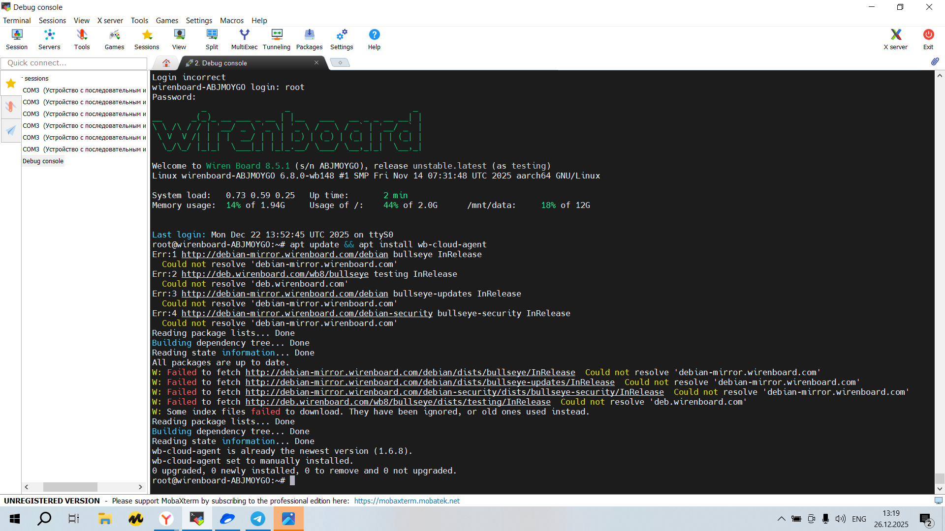

Для удобства анализа лучше присылать вывод в виде текста, а не скриншотов. На присланных изображениях видна проблема с разрешением (resolving) DNS-имен репозитория.
Рекомендую проверить работу DNS на контроллере.

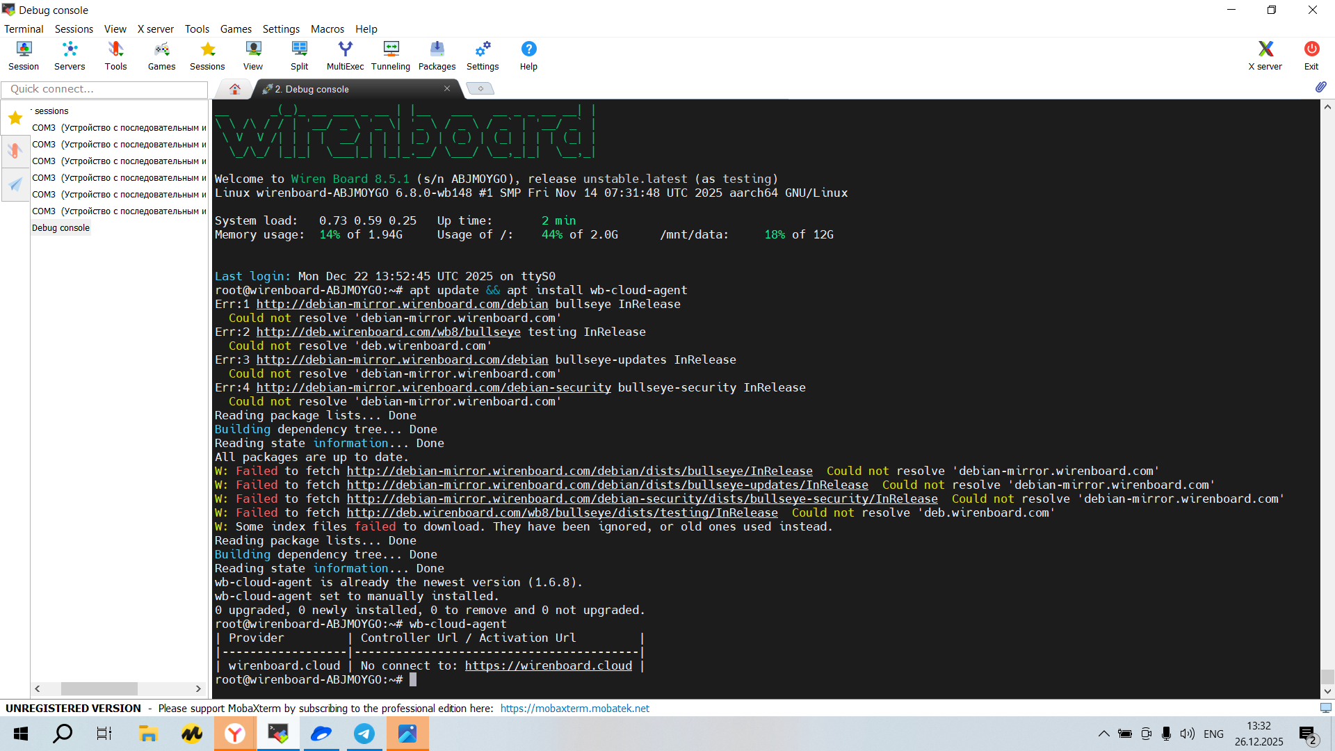

root@wirenboard-ABJMOYGO:~# wb-cloud-agent
Provider Controller Url / Activation Url
wirenboard.cloud No connect to: https://wirenboard.cloud
root@wirenboard-ABJMOYGO:~# apt update && atp install wb-cloud-agent
Err:1 Index of /debian bullseye InRelease
Could not resolve ‘debian-mirror.wirenboard.com
Err:2 http://deb.wirenboard.com/wb8/bullseye testing InRelease
Could not resolve ‘deb.wirenboard.com
Err:3 Index of /debian bullseye-updates InRelease
Err:4 Index of /debian-security bullseye-security InRelease
Reading package lists… Done
All packages are up to date.
W: Failed to fetch http://debian-mirror.wirenboard.com/debian/dists/bullseye/InRelease Could not resolve ‘debian-mirror.wirenboard.com
W: Failed to fetch http://debian-mirror.wirenboard.com/debian/dists/bullseye-updates/InRelease Could not resolve ‘debian-mirror.wirenboard.com
W: Failed to fetch http://debian-mirror.wirenboard.com/debian-security/dists/bullseye-security/InRelease Could not resolve ‘debian-mirror.wirenboard.com
W: Failed to fetch http://deb.wirenboard.com/wb8/bullseye/dists/testing/InRelease Could not resolve ‘deb.wirenboard.com
W: Some index files failed to download. They have been ignored, or old ones used instead.
-bash: atp: command not found
