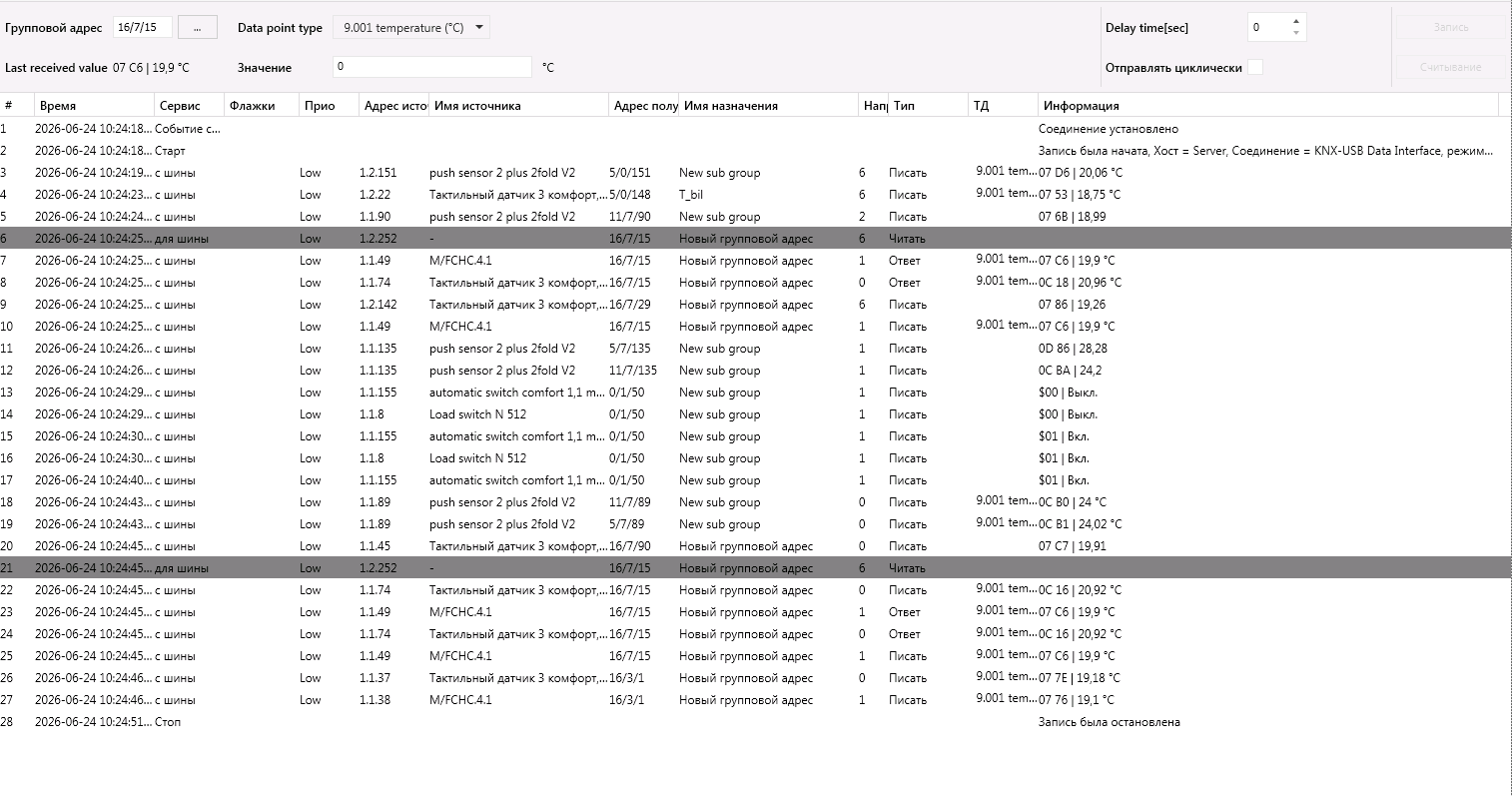

Через WB не читается групповой адрес
Попробуйте его отключить. Хочется чистую публикацию от устройства увидеть.
Попробуйте, кстати, из ETS в ГА записать.
Не только в 90, еще в 16/7/15
То есть - будет ли отличаться в debug логе записи? Обновится ли значение?
фрагмент лога wb-mqtt-knx.service с чтением ГА 16/7/15 из ETS с адаптером usb-knx
24-06-2026 10:24:47.934	DEBUG: Received from knxd: from:1.1.38 to:16/3/1 tpdu(4):00 80 07 76
24-06-2026 10:24:47.417	DEBUG: Received from knxd: from:1.1.49 to:16/7/15 tpdu(4):00 80 07 c6
24-06-2026 10:24:47.164	DEBUG: Received from knxd: from:1.1.49 to:16/7/15 tpdu(4):00 40 07 c6
24-06-2026 10:24:46.946	DEBUG: Received from knxd: from:1.2.252 to:16/7/15 tpdu(2):00 00

фрагмент knxtool groupsocketlisten local:/var/run/knx
root@wirenboard-AJKKFBOL:~# knxtool groupsocketlisten local:/var/run/knx
Write from 1.2.210 to 16/5/3: 16 A4

фрагмент debug
24-06-2026 10:41:52.771	DEBUG: Received from knxd: from:1.2.38 to:0/3/4 tpdu(2):00 81
24-06-2026 10:41:52.697	DEBUG: Received from knxd: from:1.2.198 to:0/3/4 tpdu(2):00 81
24-06-2026 10:41:52.641	DEBUG: Received from knxd: from:1.2.147 to:1/0/220 tpdu(2):00 81
24-06-2026 10:41:52.494	DEBUG: Received from knxd: from:1.2.219 to:1/7/164 tpdu(2):00 81
24-06-2026 10:41:52.373	DEBUG: Received from knxd: from:1.1.164 to:2/7/164 tpdu(2):00 81
24-06-2026 10:41:47.878	DEBUG: Received from knxd: from:1.2.219 to:1/7/164 tpdu(2):00 81
24-06-2026 10:41:47.715	DEBUG: Received from knxd: from:1.1.123 to:2/7/164 tpdu(2):00 81
24-06-2026 10:41:42.590	DEBUG: Received from knxd: from:1.2.219 to:1/7/164 tpdu(2):00 81
24-06-2026 10:41:42.435	DEBUG: Received from knxd: from:1.1.164 to:2/7/164 tpdu(2):00 81
24-06-2026 10:41:40.065	DEBUG: Received from knxd: from:1.2.89 to:5/0/89 tpdu(4):00 80 07 e9
24-06-2026 10:41:39.985	DEBUG: Received from knxd: from:1.2.89 to:11/0/89 tpdu(4):00 80 0c b0
24-06-2026 10:41:37.906	DEBUG: Received from knxd: from:1.2.219 to:1/7/164 tpdu(2):00 81
24-06-2026 10:41:37.769	DEBUG: Received from knxd: from:1.1.123 to:2/7/164 tpdu(2):00 81
24-06-2026 10:41:32.729	DEBUG: Received from knxd: from:1.1.39 to:0/0/1 tpdu(2):00 81
24-06-2026 10:41:32.620	DEBUG: Received from knxd: from:1.2.219 to:1/7/164 tpdu(2):00 81
24-06-2026 10:41:32.562	DEBUG: Received from knxd: from:1.2.208 to:1/7/164 tpdu(2):00 81
24-06-2026 10:41:32.489	DEBUG: Received from knxd: from:1.1.164 to:2/7/164 tpdu(2):00 81
24-06-2026 10:41:31.069	DEBUG: Received from knxd: from:1.1.131 to:5/7/131 tpdu(4):00 80 0c cc
24-06-2026 10:41:27.122	DEBUG: Received from knxd: from:1.2.142 to:16/7/29 tpdu(4):00 80 07 93
24-06-2026 10:41:25.252	DEBUG: Received from knxd: from:1.2.22 to:5/0/148 tpdu(4):00 80 07 65
24-06-2026 10:41:20.856	DEBUG: Received from knxd: from:1.2.89 to:5/0/89 tpdu(4):00 80 07 e9
24-06-2026 10:41:13.760	DEBUG: Received from knxd: from:1.1.38 to:16/3/16 tpdu(2):00 80
24-06-2026 10:41:11.298	DEBUG: Received from knxd: from:1.1.134 to:9/7/134 tpdu(2):00 80
24-06-2026 10:41:09.750	DEBUG: Received from knxd: from:1.2.151 to:5/0/151 tpdu(4):00 80 07 d1
24-06-2026 10:41:08.519	DEBUG: Received from knxd: from:1.1.38 to:16/3/1 tpdu(4):00 80 07 8a
24-06-2026 10:41:08.160	DEBUG: Received from knxd: from:1.1.38 to:16/3/16 tpdu(2):00 81
24-06-2026 10:41:08.004	DEBUG: Received from knxd: from:1.1.49 to:16/7/15 tpdu(4):00 80 07 c6
24-06-2026 10:41:05.298	DEBUG: Received from knxd: from:1.2.200 to:1/6/66 tpdu(2):00 80
24-06-2026 10:41:05.272	DEBUG: Received from knxd: from:1.2.3 to:0/1/18 tpdu(2):00 80
24-06-2026 10:41:05.219	DEBUG: Received from knxd: from:1.2.10 to:0/1/16 tpdu(2):00 80
24-06-2026 10:41:05.192	DEBUG: Received from knxd: from:1.2.242 to:1/0/66 tpdu(2):00 80
24-06-2026 10:40:59.876	DEBUG: Received from knxd: from:1.2.150 to:5/0/150 tpdu(4):00 80 07 91
24-06-2026 10:40:59.796	DEBUG: Received from knxd: from:1.2.150 to:11/0/150 tpdu(4):00 80 07 af
24-06-2026 10:40:48.074	DEBUG: Received from knxd: from:1.2.210 to:16/5/3 tpdu(4):00 80 16 a4
24-06-2026 10:40:27.129	DEBUG: Received from knxd: from:1.2.142 to:16/7/29 tpdu(4):00 80 07 92
24-06-2026 10:40:25.258	DEBUG: Received from knxd: from:1.2.22 to:5/0/148 tpdu(4):00 80 07 58
24-06-2026 10:40:22.713	DEBUG: Received from knxd: from:1.1.193 to:9/7/193 tpdu(2):00 80
24-06-2026 10:40:20.988	DEBUG: Received from knxd: from:1.1.132 to:9/7/132 tpdu(2):00 80
24-06-2026 10:40:20.233	DEBUG: Received from knxd: from:1.1.162 to:2/7/162 tpdu(2):00 80
24-06-2026 10:40:16.695	DEBUG: Received from knxd: from:1.1.47 to:16/6/9 tpdu(2):00 80
24-06-2026 10:40:14.397	DEBUG: Received from knxd: from:1.3.5 to:16/7/47 tpdu(2):00 80
24-06-2026 10:40:14.369	DEBUG: Received from knxd: from:1.3.5 to:16/7/46 tpdu(2):00 80
24-06-2026 10:40:14.341	DEBUG: Received from knxd: from:1.3.5 to:16/7/45 tpdu(2):00 80
24-06-2026 10:40:13.788	DEBUG: Received from knxd: from:1.1.49 to:16/7/24 tpdu(2):00 80
24-06-2026 10:40:13.588	DEBUG: Sent to knxd: to:16/7/70 tpdu(3):00 80 00
24-06-2026 10:40:11.095	DEBUG: Received from knxd: from:1.1.47 to:16/6/9 tpdu(2):00 81
24-06-2026 10:40:10.744	DEBUG: Received from knxd: from:1.3.5 to:16/7/50 tpdu(2):00 80
24-06-2026 10:40:10.580	DEBUG: Sent to knxd: to:16/7/72 tpdu(2):00 80
24-06-2026 10:40:10.576	DEBUG: Sent to knxd: to:16/7/71 tpdu(2):00 80
24-06-2026 10:40:10.554	DEBUG: Sent to knxd: to:16/7/72 tpdu(2):00 80
24-06-2026 10:40:10.550	DEBUG: Sent to knxd: to:16/7/71 tpdu(2):00 80
24-06-2026 10:40:10.523	DEBUG: Received from knxd: from:1.2.151 to:5/0/151 tpdu(4):00 80 07 cd
24-06-2026 10:40:08.189	DEBUG: Received from knxd: from:1.1.49 to:16/7/24 tpdu(2):00 81
24-06-2026 10:40:08.156	DEBUG: Received from knxd: from:1.1.38 to:16/3/1 tpdu(4):00 80 07 80
24-06-2026 10:40:08.126	DEBUG: Received from knxd: from:1.1.49 to:16/7/15 tpdu(4):00 80 07 c6
24-06-2026 10:40:04.047	DEBUG: Received from knxd: from:1.1.39 to:0/0/1 tpdu(2):00 80
24-06-2026 10:40:03.895	DEBUG: Received from knxd: from:1.2.208 to:1/7/164 tpdu(2):00 80
24-06-2026 10:40:00.903	DEBUG: Received from knxd: from:1.2.150 to:5/0/150 tpdu(4):00 80 07 8f
24-06-2026 10:40:00.431	DEBUG: Received from knxd: from:1.2.219 to:1/7/162 tpdu(2):00 81
24-06-2026 10:40:00.269	DEBUG: Received from knxd: from:1.1.162 to:2/7/162
tpdu(2):00 81
фрагмент knxtool vbusmonitor1 local:/var/run/knx | grep “16/7/90”
root@wirenboard-AJKKFBOL:~# knxtool vbusmonitor1 local:/var/run/knx | grep "16/7/90"
L_Busmon: BC 11 2D 87 5A 83 00 80 07 A3 05 :L_Data low from 1.1.45 to 16/7/90 hops: 00 T_Data_Group A_GroupValue_Write 07 A3
L_Busmon: BC 11 2D 87 5A 83 00 80 07 9D 3B :L_Data low from 1.1.45 to 16/7/90 hops: 00 T_Data_Group A_GroupValue_Write 07 9D
L_Busmon: BC 11 2D 87 5A 83 00 80 07 97 31 :L_Data low from 1.1.45 to 16/7/90 hops: 00 T_Data_Group A_GroupValue_Write 07 97
^C
все фрагменты включают единый промежуток времени
Замечательно.
Вижу тут несколько от 1.1.49 на этот ГА
Ну и
При этом не вижу присутствующий на скриншоте в 10:24:45 запись в 16/7/90
Возможных причин - скорее всего две.
Или с шиной что-то (ну, маловероятно).
Но проверить - нужно. Есть возможность оставить на шине только 1.1.45? Например подключить его отдельным временным кабелем?
Или отключить часть остальных устройств?
Вторая причина - что-то с самим ГА. Как и предлагал ранее поменяйте для проверки ГА местами.
А при чем тут шина? Ситуация выглядит так вроде:
vbusmonitor1 видит 16/7/90
groupsocketlisten не видит 16/7/90
wb-mqtt-knx тоже не видит 16/7/90
Поменять местами ГА, отключать устройства и прочее - крайне нежелательно - оборудование в действующем объекте.
Да, поэтому и предполагаю что какая-то проблема адресно-специфическая: для 16/7/90 телеграмма видна на bus monitor уровне, но не проходит в поток групповых событий, который отправляется в groupsocketlisten/wb-mqtt-knx.
Так как на уровне шины видно - то да, отключать и переключать шину не имеет смысла.
Но сменить адрес - для проверки нужно.
Ну и да, еще один способ: создать например 16/7/91 в wb-mqtt-knx; попробовать отправить в него из ETS значение.
Попробовать опять же из ETS в 16/7/90
ну и с контроллера
knxtool groupwrite ip:localhost 16/7/91 07 c6
knxtool groupwrite ip:localhost 16/7/90 07 c6
Получилось проверить?
