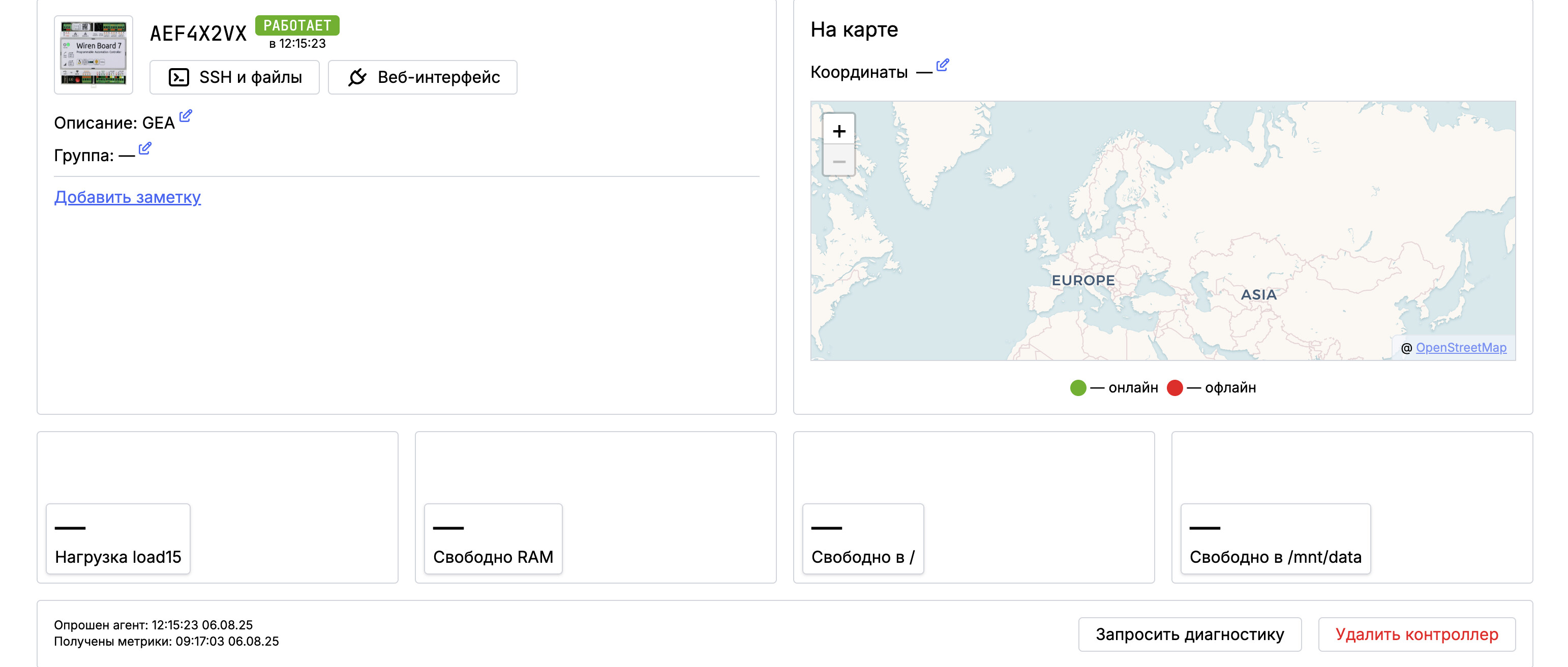

Не отображаются метрики
почему-то нет метрик
(304,6 КБ)
Из лога wb-mqtt-metrics:
Aug 04 21:55:41 wirenboard-AEF4X2VX systemd[1]: Started metrics sender.
Aug 04 22:06:02 wirenboard-AEF4X2VX /usr/bin/wb-metrics[2619]: Unexpected disconnection.
Aug 06 09:15:31 wirenboard-AEF4X2VX systemd[1]: Stopping metrics sender...
Aug 06 09:15:31 wirenboard-AEF4X2VX /usr/bin/wb-metrics[2619]: Removing virtual device
Aug 06 09:15:31 wirenboard-AEF4X2VX /usr/bin/wb-metrics[2619]: Stopping mqtt client
Aug 06 09:15:32 wirenboard-AEF4X2VX wb-metrics[2619]: Traceback (most recent call last):
Aug 06 09:15:32 wirenboard-AEF4X2VX wb-metrics[2619]:   File "/usr/bin/wb-metrics", line 8, in <module>
Aug 06 09:15:32 wirenboard-AEF4X2VX wb-metrics[2619]:     sys.exit(main())
Aug 06 09:15:32 wirenboard-AEF4X2VX wb-metrics[2619]:   File "/usr/lib/python3/dist-packages/wb/mqtt_metrics/metrics_sender.py", line 87, in main
Aug 06 09:15:32 wirenboard-AEF4X2VX wb-metrics[2619]:     client.run(period)
Aug 06 09:15:32 wirenboard-AEF4X2VX wb-metrics[2619]:   File "/usr/lib/python3/dist-packages/wb/mqtt_metrics/metrics_sender.py", line 54, in run
Aug 06 09:15:32 wirenboard-AEF4X2VX wb-metrics[2619]:     metric.send()
Aug 06 09:15:32 wirenboard-AEF4X2VX wb-metrics[2619]:   File "/usr/lib/python3/dist-packages/wb/mqtt_metrics/metrics.py", line 100, in send
Aug 06 09:15:32 wirenboard-AEF4X2VX wb-metrics[2619]:     ram_data = get_ram_data()
Aug 06 09:15:32 wirenboard-AEF4X2VX wb-metrics[2619]:   File "/usr/lib/python3/dist-packages/wb/mqtt_metrics/metrics.py", line 18, in get_ram_data
Aug 06 09:15:32 wirenboard-AEF4X2VX wb-metrics[2619]:     memory_data = cmd_res[1].decode()
Aug 06 09:15:32 wirenboard-AEF4X2VX wb-metrics[2619]: IndexError: list index out of range
Aug 06 09:15:33 wirenboard-AEF4X2VX systemd[1]: wb-mqtt-metrics.service: Main process exited, code=exited, status=1/FAILURE
Aug 06 09:15:33 wirenboard-AEF4X2VX systemd[1]: wb-mqtt-metrics.service: Failed with result 'exit-code'.
А если эту службу перезапустить вручную - она стартует?
Добрый день. Получилось перезапустить?
Да получилось, спасибо
