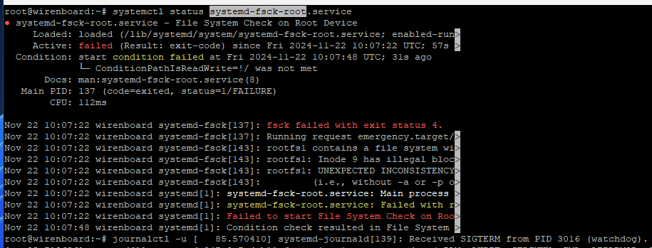

потом при загрузке
[  OK  ] Mounted FUSE Control File System.
[    7.103937] systemd[1]: Unnecessary job for /dev/ttyS0 was removed.
[    7.120267] systemd[1]: systemd-fsck-root.service: Main process exited, code=exited, status=1/FAILURE
[    7.133042] systemd[1]: systemd-fsck-root.service: Failed with result 'exit-code'.
[    7.142505] systemd[1]: Failed to start File System Check on Root Device.
[FAILED] Failed to start File System Check on Root Device.
See 'systemctl status systemd-fsck-root.service' for details.
[    7.214026] systemd[1]: Started Journal Service.
[  OK  ] Started Journal Service.
[  OK  ] Finished Apply Kernel Variables.
ждет ввода
You are in emergency mode. After logging in, type "journalctl -xb" to view
system logs, "systemctl reboot" to reboot, "systemctl default" or "exit"
to boot into default mode.
Give root password for maintenance

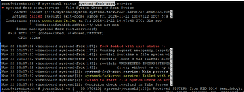

(or press Control-D to continue): [   33.762798] vcc-gmac-phy: disabling
по [Ctrl+D] процесс продолжается, могу залогиниться, успеваю посмотреть:
и дальше watchdog отправляет контроллер в перезагрузку
[EC] Watchdog is timed out, reset power.
