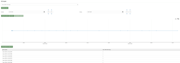

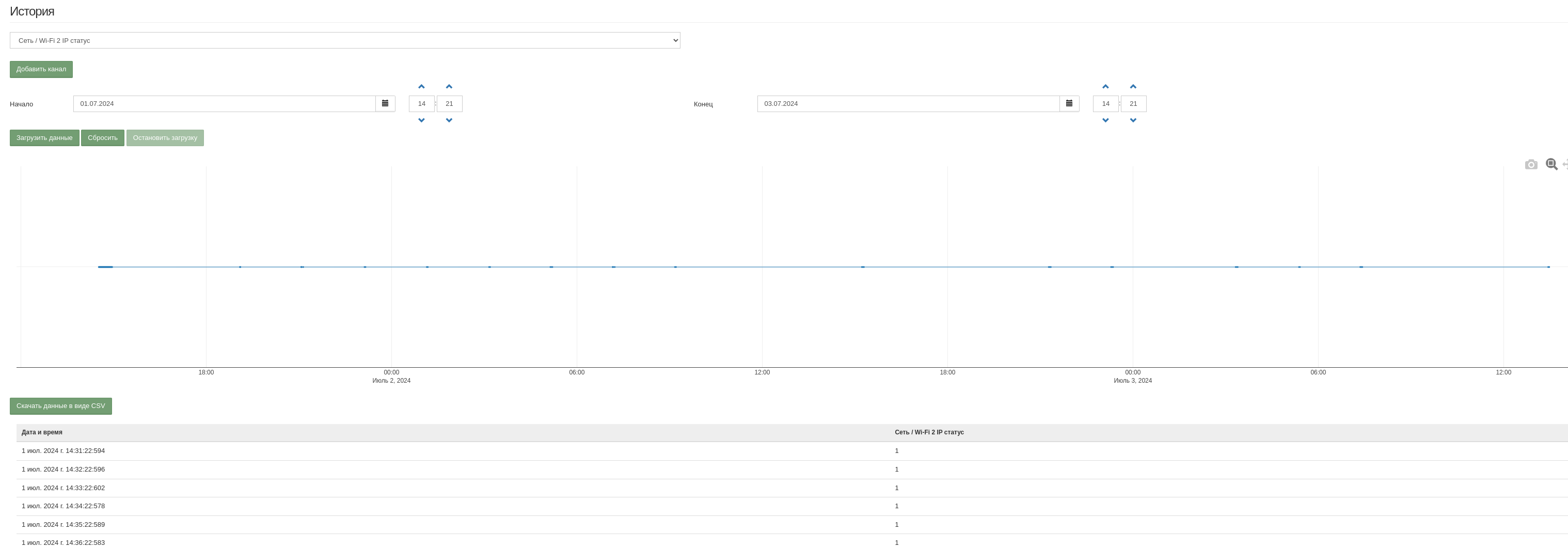

Добрый день, удалось воспроизвести?
Работало с пятницы бесперебойно, сейчас для проверки решил попробовать с заведомо неверным паролем:
Jul 01 08:24:59 wirenboard-AYK5U4TB NetworkManager[651]: <info>  [1719822299.5876] device (wlan0): supplicant interface state: inactive -> scanning
Jul 01 08:24:59 wirenboard-AYK5U4TB NetworkManager[651]: <info>  [1719822299.5878] device (p2p-dev-wlan0): supplicant management interface state: inactive -> scanning
Jul 01 08:25:04 wirenboard-AYK5U4TB wpa_supplicant[483]: wlan0: Trying to associate with f8:f0:82:7f:8c:6b (SSID='hideSsid' freq=2412 MHz)
Jul 01 08:25:04 wirenboard-AYK5U4TB wpa_supplicant[483]: nl80211: kernel reports: Authentication algorithm number required
Jul 01 08:25:04 wirenboard-AYK5U4TB kernel: RTW: rtw_set_802_11_connect(wlan0)  fw_state=0x00000008
Jul 01 08:25:04 wirenboard-AYK5U4TB NetworkManager[651]: <info>  [1719822304.0350] device (wlan0): supplicant interface state: scanning -> associating
Jul 01 08:25:04 wirenboard-AYK5U4TB NetworkManager[651]: <info>  [1719822304.0352] device (p2p-dev-wlan0): supplicant management interface state: scanning -> associating
Jul 01 08:25:04 wirenboard-AYK5U4TB wpa_supplicant[483]: wlan0: CTRL-EVENT-STARTED-CHANNEL-SWITCH freq=2412 ht_enabled=1 ch_offset=0 ch_width=20 MHz cf1=2412 cf2=0
Jul 01 08:25:04 wirenboard-AYK5U4TB kernel: RTW: start auth
Jul 01 08:25:04 wirenboard-AYK5U4TB kernel: RTW: auth success, start assoc
Jul 01 08:25:04 wirenboard-AYK5U4TB kernel: RTW: assoc success
Jul 01 08:25:04 wirenboard-AYK5U4TB wpa_supplicant[483]: wlan0: Associated with f8:f0:82:7f:8c:6b
Jul 01 08:25:04 wirenboard-AYK5U4TB wpa_supplicant[483]: wlan0: CTRL-EVENT-SUBNET-STATUS-UPDATE status=0
Jul 01 08:25:04 wirenboard-AYK5U4TB kernel: RTW: recv eapol packet 1/4
Jul 01 08:25:04 wirenboard-AYK5U4TB kernel: RTW: send eapol packet 2/4
Jul 01 08:25:04 wirenboard-AYK5U4TB NetworkManager[651]: <info>  [1719822304.5737] device (wlan0): supplicant interface state: associating -> 4way_handshake
Jul 01 08:25:04 wirenboard-AYK5U4TB NetworkManager[651]: <info>  [1719822304.5740] device (p2p-dev-wlan0): supplicant management interface state: associating -> 4way_handshake
Jul 01 08:25:05 wirenboard-AYK5U4TB kernel: RTW: recv eapol packet 1/4
Jul 01 08:25:05 wirenboard-AYK5U4TB kernel: RTW: send eapol packet 2/4
Jul 01 08:25:06 wirenboard-AYK5U4TB kernel: RTW: recv eapol packet 1/4
Jul 01 08:25:06 wirenboard-AYK5U4TB kernel: RTW: send eapol packet 2/4
Jul 01 08:25:07 wirenboard-AYK5U4TB kernel: RTW: recv eapol packet 1/4
Jul 01 08:25:07 wirenboard-AYK5U4TB kernel: RTW: send eapol packet 2/4
Jul 01 08:25:08 wirenboard-AYK5U4TB kernel: RTW: OnDeAuth(wlan0) reason=15, ta=f8:f0:82:7f:8c:6b, ignore=0
Jul 01 08:25:08 wirenboard-AYK5U4TB wpa_supplicant[483]: wlan0: CTRL-EVENT-DISCONNECTED bssid=f8:f0:82:7f:8c:6b reason=15
Jul 01 08:25:08 wirenboard-AYK5U4TB wpa_supplicant[483]: wlan0: WPA: 4-Way Handshake failed - pre-shared key may be incorrect
Jul 01 08:25:08 wirenboard-AYK5U4TB wpa_supplicant[483]: wlan0: CTRL-EVENT-SSID-TEMP-DISABLED id=0 ssid="hideSsid" auth_failures=1 duration=10 reason=WRONG_KEY
Jul 01 08:25:08 wirenboard-AYK5U4TB wpa_supplicant[483]: wlan1: CTRL-EVENT-REGDOM-CHANGE init=CORE type=WORLD
Jul 01 08:25:08 wirenboard-AYK5U4TB NetworkManager[651]: <info>  [1719822308.5820] device (wlan0): supplicant interface state: 4way_handshake -> disconnected
Jul 01 08:25:08 wirenboard-AYK5U4TB NetworkManager[651]: <info>  [1719822308.5823] device (wlan0): Activation: (wifi) disconnected during association, asking for new key
Jul 01 08:25:08 wirenboard-AYK5U4TB NetworkManager[651]: <info>  [1719822308.5827] device (wlan0): state change: config -> need-auth (reason 'supplicant-disconnect', sys-iface-state: 'managed')
Jul 01 08:25:08 wirenboard-AYK5U4TB NetworkManager[651]: <info>  [1719822308.5845] device (p2p-dev-wlan0): supplicant management interface state: 4way_handshake -> disconnected
Jul 01 08:25:08 wirenboard-AYK5U4TB NetworkManager[651]: <warn>  [1719822308.5878] device (wlan0): no secrets: No agents were available for this request.
Jul 01 08:25:08 wirenboard-AYK5U4TB NetworkManager[651]: <info>  [1719822308.5880] device (wlan0): state change: need-auth -> failed (reason 'no-secrets', sys-iface-state: 'managed')
Jul 01 08:25:08 wirenboard-AYK5U4TB NetworkManager[651]: <warn>  [1719822308.5918] device (wlan0): Activation: failed for connection 'hideSsid'

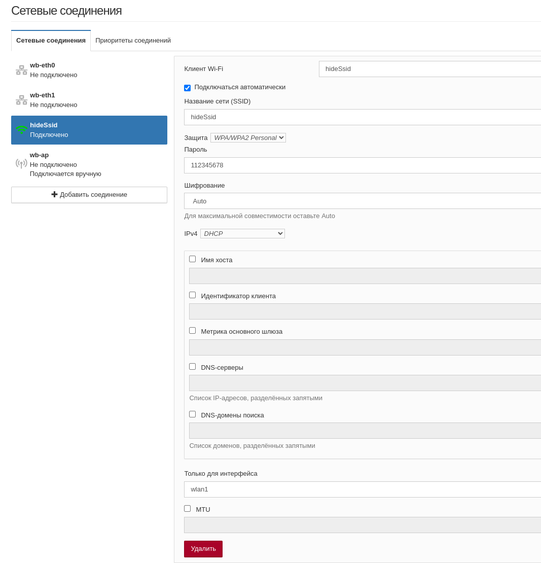

Настройка стандартная:
Попробую еще поотключать саму точку доступа для того чтобы воспроизвести разрывы связи.

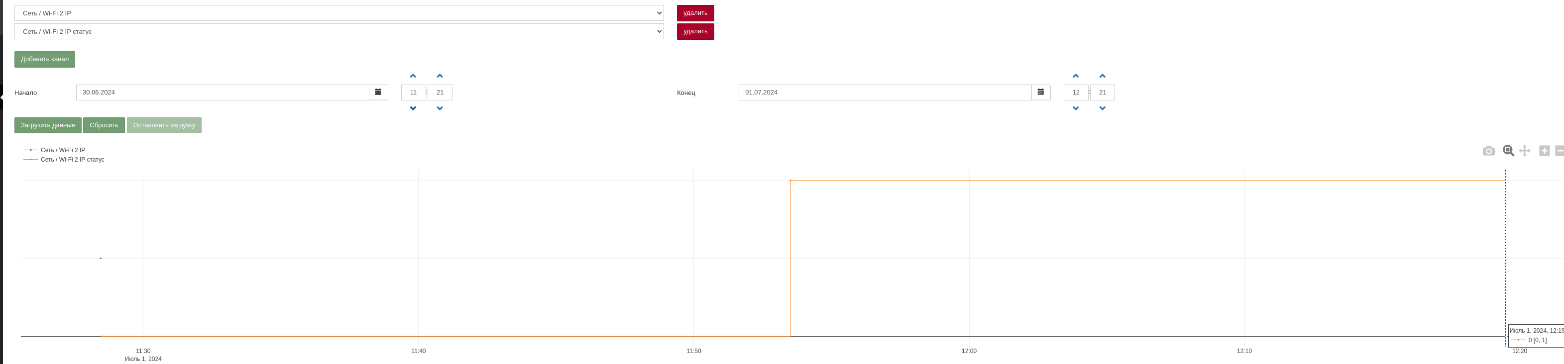

Попробуйте отключить точку доступа на минут 30, затем включить и понаблюдайте, подключиться ли контроллер самостоятельно к ней.
Да. Отключил дочку доступа от питания, затем включил… Контроллер в wb-cloud появился через минуту.
Проработал два дня, ошибок и разрывов нет.
Ну, видимо проблема в сети Wi-Fi, спасибо за помощь.
