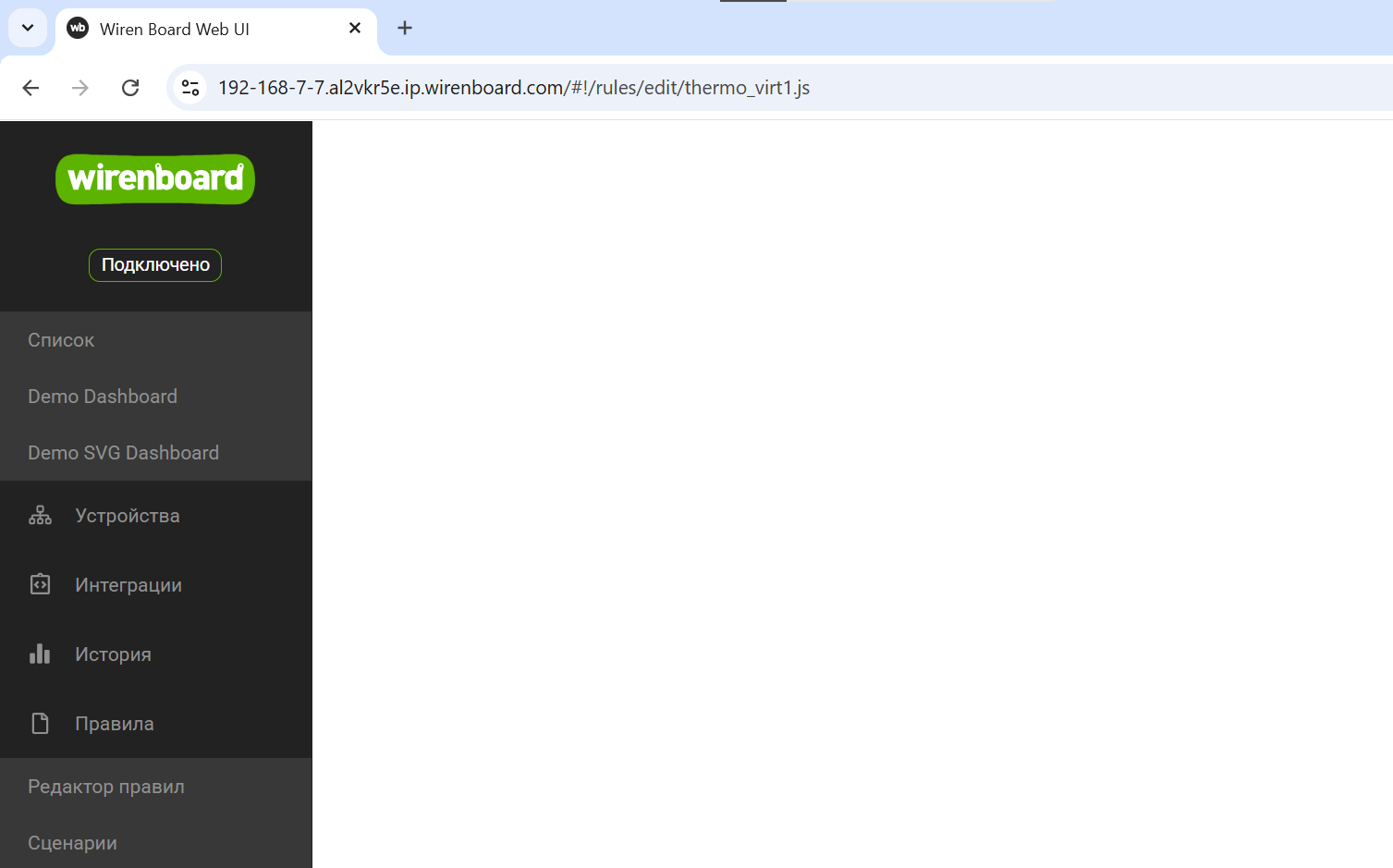

Сломан редактор правил
версия wb-2602
Summary
Тоже самое в инкогнито и после ребута. В логах ошибок нет

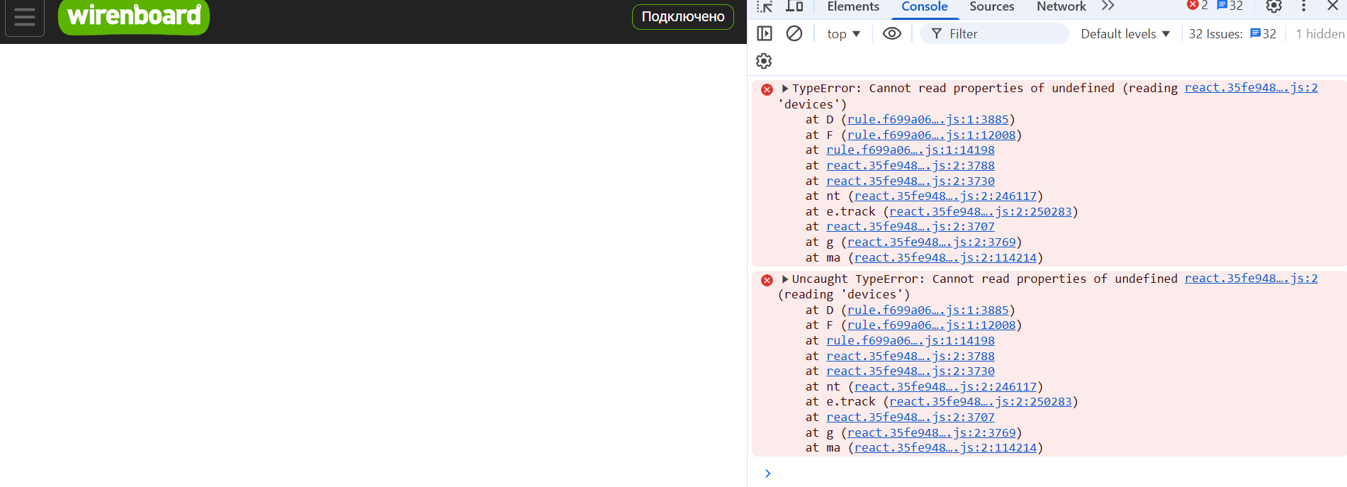

в консоли разработчика:
main.64f4336ac8578a176571.js:1 Connected to wss://192-168-ХХ-ХХХ.al2ZZZ.ip.wirenboard.com/mqtt as ‘wb-mqtt-homeui-***’
react.35fe9480e846794f12a9.js:2 TypeError: Cannot read properties of undefined (reading ‘devices’)
at D (rule.f699a06405d43a493f4e.js:1:3885)
at F (rule.f699a06405d43a493f4e.js:1:12008)
at rule.f699a06405d43a493f4e.js:1:14198
at react.35fe9480e846794f12a9.js:2:3788
at react.35fe9480e846794f12a9.js:2:3730
at nt (react.35fe9480e846794f12a9.js:2:246117)
at t.track (react.35fe9480e846794f12a9.js:2:250283)
at react.35fe9480e846794f12a9.js:2:3707
at g (react.35fe9480e846794f12a9.js:2:3769)
at ma (react.35fe9480e846794f12a9.js:2:114214)
fu @ react.35fe9480e846794f12a9.js:2
n.callback @ react.35fe9480e846794f12a9.js:2
Wo @ react.35fe9480e846794f12a9.js:2
_l @ react.35fe9480e846794f12a9.js:2
yl @ react.35fe9480e846794f12a9.js:2
gl @ react.35fe9480e846794f12a9.js:2
(anonymous) @ react.35fe9480e846794f12a9.js:2
ws @ react.35fe9480e846794f12a9.js:2
is @ react.35fe9480e846794f12a9.js:2
x @ 483.97c1d3cea4f06c176458.js:2
T @ 483.97c1d3cea4f06c176458.js:2
react.35fe9480e846794f12a9.js:2 Uncaught TypeError: Cannot read properties of undefined (reading ‘devices’)
D @ rule.f699a06405d43a493f4e.js:1
F @ rule.f699a06405d43a493f4e.js:1
(anonymous) @ rule.f699a06405d43a493f4e.js:1
nt @ react.35fe9480e846794f12a9.js:2
t.track @ react.35fe9480e846794f12a9.js:2
g @ react.35fe9480e846794f12a9.js:2
ma @ react.35fe9480e846794f12a9.js:2
Eu @ react.35fe9480e846794f12a9.js:2
ku @ react.35fe9480e846794f12a9.js:2
Su @ react.35fe9480e846794f12a9.js:2
kl @ react.35fe9480e846794f12a9.js:2
ys @ react.35fe9480e846794f12a9.js:2
bs @ react.35fe9480e846794f12a9.js:2
ms @ react.35fe9480e846794f12a9.js:2
os @ react.35fe9480e846794f12a9.js:2
