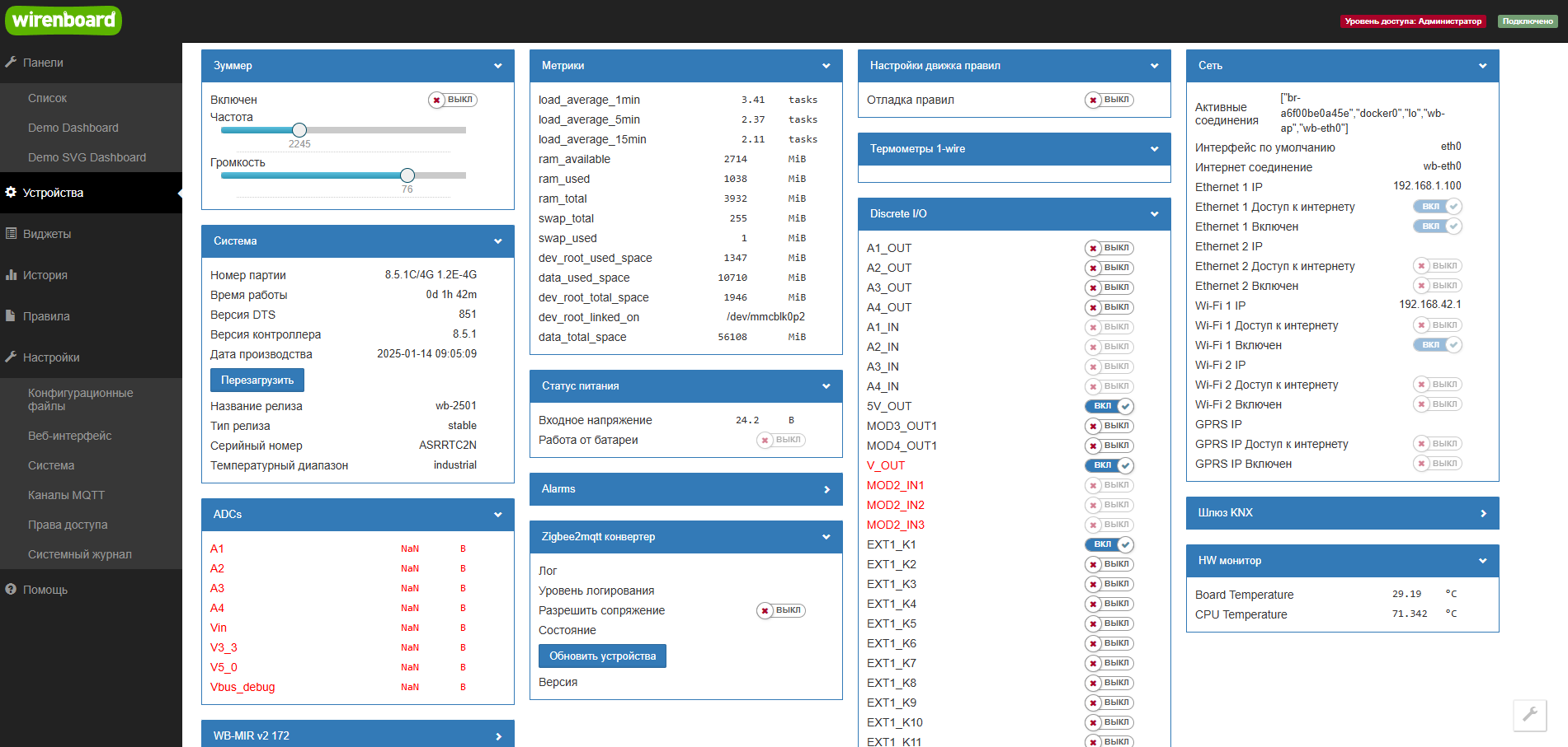

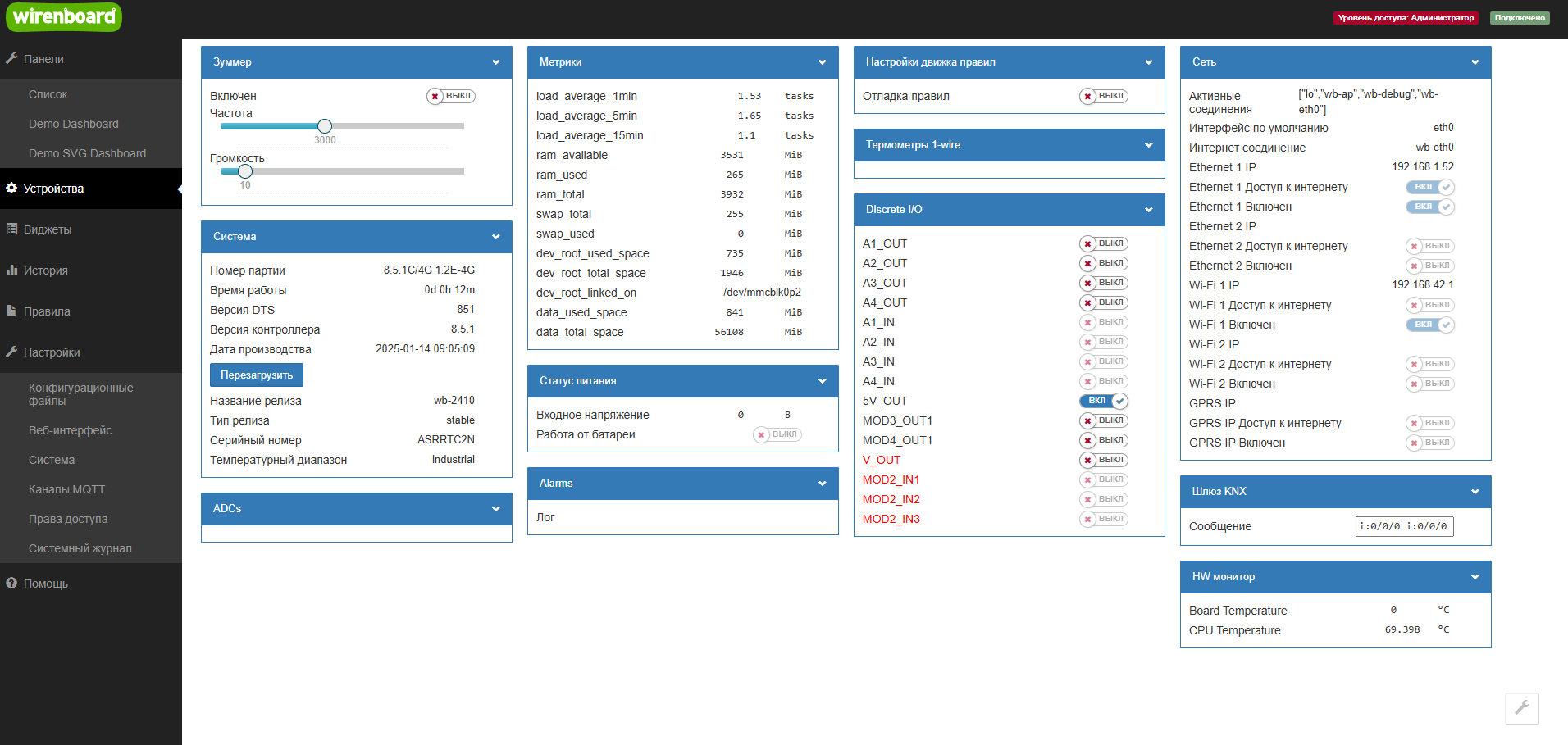

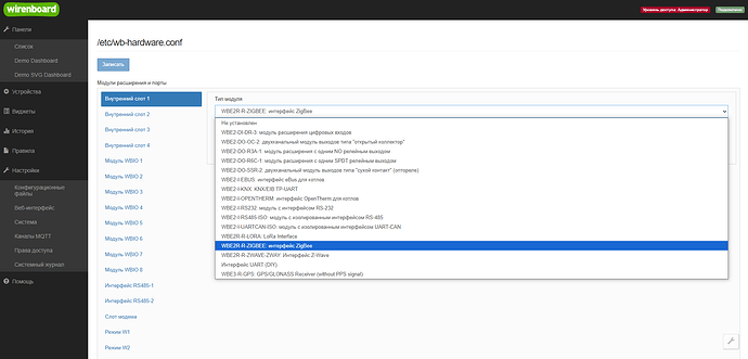

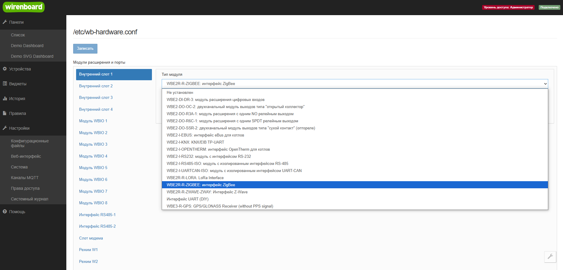

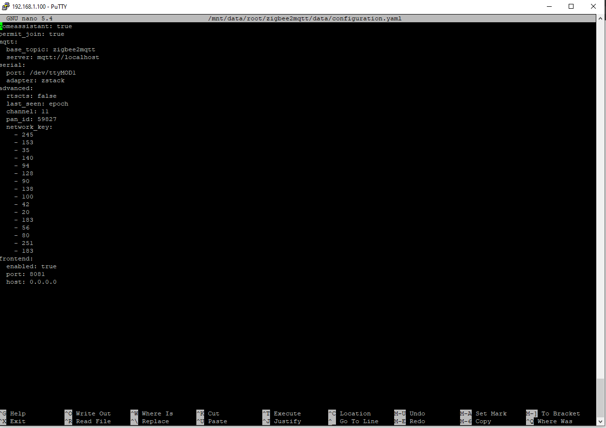

WB8.5 + Модуль расширения [WBE2R-R-ZIGBEE v.2] в модуле 1.
устанавливал по инструкции тут .
такую ошибку выдаёт
это первая установка, до этого ничего не ставилось, только достал из коробки.
root@wirenboard-ASRRTC2N:/mnt/data# journalctl -u zigbee2mqtt -f
– Journal begins at Sun 2024-08-25 19:05:35 UTC. –
Mar 11 18:59:02 wirenboard-ASRRTC2N npm[21874]: [2025-03-11 18:59:02] error: zh:zstack:znp: Failed to determine if path is valid: ‘Error: ENOENT: no such file or directory, lstat ‘/dev/ttyMOD1’’
Mar 11 18:59:02 wirenboard-ASRRTC2N npm[21874]: [2025-03-11 18:59:02] info: zh:zstack:znp: Opening SerialPort with {“path”:“/dev/ttyMOD1”,“baudRate”:115200,“rtscts”:false,“autoOpen”:false}
Mar 11 18:59:02 wirenboard-ASRRTC2N npm[21874]: [2025-03-11 18:59:02] error: z2m: Error while starting zigbee-herdsman
Mar 11 18:59:02 wirenboard-ASRRTC2N npm[21874]: [2025-03-11 18:59:02] error: z2m: Failed to start zigbee
Mar 11 18:59:02 wirenboard-ASRRTC2N npm[21874]: [2025-03-11 18:59:02] error: z2m: Check https://www.zigbee2mqtt.io/guide/installation/20_zigbee2mqtt-fails-to-start.html for possible solutions
Mar 11 18:59:02 wirenboard-ASRRTC2N npm[21874]: [2025-03-11 18:59:02] error: z2m: Exiting…
Mar 11 18:59:02 wirenboard-ASRRTC2N npm[21874]: [2025-03-11 18:59:02] error: z2m: Error: Error: No such file or directory, cannot open /dev/ttyMOD1
