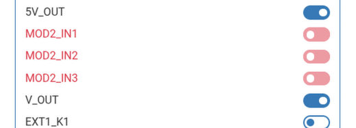

Не работает DI-DR-3
После последних обновлений на testing перестал определяться модуль дискретных входов.
Wiren Board 8.5.3 release unstable.latest (as testing)
в логах
13-02-2026 13:16:16.052 [wb-mqtt-gpio] ERROR: [gpio chip driver] Failed to init polling GPIO line 0:10 (MOD2_IN3). Treating as initially disconnected
13-02-2026 13:16:16.052 [wb-mqtt-gpio] ERROR: [gpio chip driver] Failed to init polling GPIO line 0:9 (MOD2_IN2). Treating as initially disconnected
13-02-2026 13:16:16.052 [wb-mqtt-gpio] ERROR: [gpio chip driver] Failed to init polling GPIO line 0:8 (MOD2_IN1). Treating as initially disconnected
13-02-2026 13:16:16.052 [wb-mqtt-gpio] ERROR: [gpio chip driver] GPIO_GET_LINEHANDLE_IOCTL failed: Device or resource busy\
13-02-2026 13:16:16.046 [wb-mqtt-gpio] ERROR: [gpio chip driver] Skipping GPIO line 0:10 (MOD2_IN3)
13-02-2026 13:16:16.046 [wb-mqtt-gpio] ERROR: [gpio chip driver] Failed to release GPIO line 0:10 (MOD2_IN3)
13-02-2026 13:16:16.046 [wb-mqtt-gpio] ERROR: [gpio chip driver] Skipping GPIO line 0:9 (MOD2_IN2)
13-02-2026 13:16:16.046 [wb-mqtt-gpio] ERROR: [gpio chip driver] Failed to release GPIO line 0:9 (MOD2_IN2)
13-02-2026 13:16:16.046 [wb-mqtt-gpio] ERROR: [gpio chip driver] Skipping GPIO line 0:8 (MOD2_IN1)
13-02-2026 13:16:16.046 [wb-mqtt-gpio] ERROR: [gpio chip driver] Failed to release GPIO line 0:8 (MOD2_IN1)
13-02-2026 13:16:10.824 [wb-mqtt-gpio] ERROR: [gpio chip driver] Failed to init polling GPIO line 0:10 (MOD2_IN3). Treating as initially disconnected
13-02-2026 13:16:10.824 [wb-mqtt-gpio] ERROR: [gpio chip driver] Failed to init polling GPIO line 0:9 (MOD2_IN2). Treating as initially disconnected
13-02-2026 13:16:10.824 [wb-mqtt-gpio] ERROR: [gpio chip driver] Failed to init polling GPIO line 0:8 (MOD2_IN1). Treating as initially disconnected
13-02-2026 13:16:10.824 [wb-mqtt-gpio] ERROR: [gpio chip driver] GPIO_GET_LINEHANDLE_IOCTL failed: Device or resource busy
13-02-2026 13:16:10.822 [wb-mqtt-gpio] ERROR: [gpio chip driver] Skipping GPIO line 0:10 (MOD2_IN3)
13-02-2026 13:16:10.822 [wb-mqtt-gpio] ERROR: [gpio chip driver] Failed to release GPIO line 0:10 (MOD2_IN3)
13-02-2026 13:16:10.822 [wb-mqtt-gpio] ERROR: [gpio chip driver] Skipping GPIO line 0:9 (MOD2_IN2)
13-02-2026 13:16:10.822 [wb-mqtt-gpio] ERROR: [gpio chip driver] Failed to release GPIO line 0:9 (MOD2_IN2)
13-02-2026 13:16:10.822 [wb-mqtt-gpio] ERROR: [gpio chip driver] Skipping GPIO line 0:8 (MOD2_IN1)
13-02-2026 13:16:10.822 [wb-mqtt-gpio] ERROR: [gpio chip driver] Failed to release GPIO line 0:8 (MOD2_IN1)
