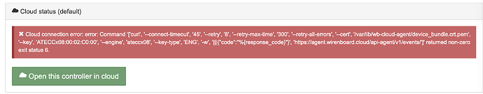

После перезагрузки, слетает wirenboard.cloud
Cloud connection error: error: Command '['curl', '--connect-timeout', '45', '--retry', '8', '--retry-max-time', '300', '--retry-all-errors', '--cert', '/var/lib/wb-cloud-agent/device_bundle.crt.pem', '--key', 'ATECCx08:00:02:C0:00', '--engine', 'ateccx08', '--key-type', 'ENG', '-w', '|||{"code":"%{response_code}"}', 'https://agent.wirenboard.cloud/api-agent/v1/events/']' returned non-zero exit status 6.
Welcome to Wiren Board 7.3.4 (s/n), release unstable.latest (as testing)
Linux wirenboard- 5.10.35-wb169 #1 SMP Wed Aug 7 14:39:59 UTC 2024 armv7l GNU/Linux
