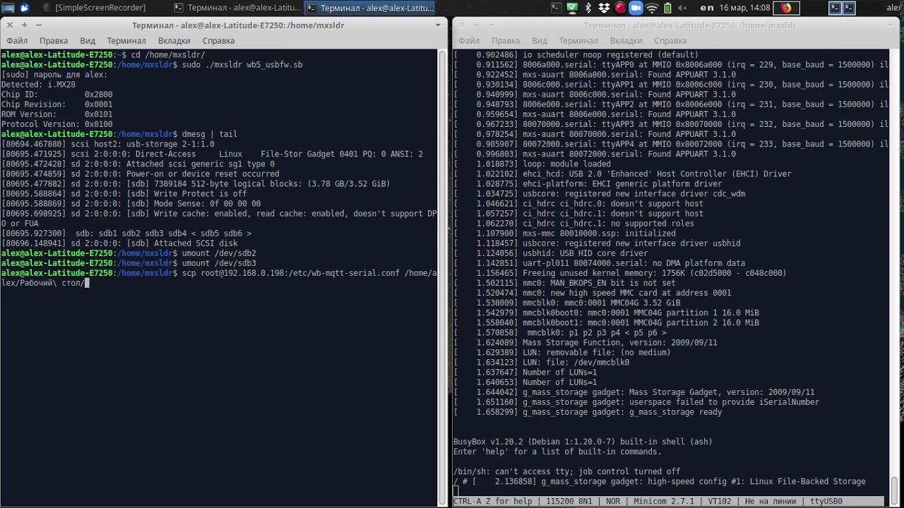

Окей, запускаем в Parallels Ubuntu 18.04, подключаем USB шнурок, sudo ./Mxsldr.bin wb5_usbfw.sb - сработал! Устройство Wiren Board появилось, вот только диск почему-то на 32Mb. Снимаем перемычку как написано в инструкции, ничего не изменилось:

В dmesg при этом:
[ 2061.961091] usb 1-5: new high-speed USB device number 15 using ehci-pci
[ 2062.117798] usb 1-5: New USB device found, idVendor=15a2, idProduct=004f
[ 2062.117800] usb 1-5: New USB device strings: Mfr=1, Product=2, SerialNumber=0
[ 2062.117800] usb 1-5: Product: ROM Recovery
[ 2062.117801] usb 1-5: Manufacturer: Freescale,Inc.
[ 2062.121211] hid-generic 0003:15A2:004F.0008: hiddev3,hidraw2: USB HID v1.10 Device [Freescale,Inc. ROM Recovery] on usb-0000:00:1d.7-5/input0
[ 2076.659309] usb 1-5: USB disconnect, device number 15
[ 2077.076873] usb 1-6: new high-speed USB device number 16 using ehci-pci
[ 2077.234626] usb 1-6: New USB device found, idVendor=0525, idProduct=a4a5
[ 2077.234628] usb 1-6: New USB device strings: Mfr=3, Product=4, SerialNumber=0
[ 2077.234629] usb 1-6: Product: Wiren Board
[ 2077.234629] usb 1-6: Manufacturer: Wiren Board
[ 2077.237137] usb-storage 1-6:1.0: USB Mass Storage device detected
[ 2077.237704] usb-storage 1-6:1.0: Quirks match for vid 0525 pid a4a5: 10000
[ 2077.237796] scsi host8: usb-storage 1-6:1.0
[ 2078.258726] scsi 8:0:0:0: Direct-Access Linux File-Stor Gadget 0401 PQ: 0 ANSI: 2
[ 2078.259504] sd 8:0:0:0: Attached scsi generic sg2 type 0
[ 2078.264383] sd 8:0:0:0: Power-on or device reset occurred
[ 2078.268424] sd 8:0:0:0: [sdb] 62688 512-byte logical blocks: (32.1 MB/30.6 MiB)
[ 2078.372232] sd 8:0:0:0: [sdb] Write Protect is off
[ 2078.372237] sd 8:0:0:0: [sdb] Mode Sense: 0f 00 00 00
[ 2078.482101] sd 8:0:0:0: [sdb] Write cache: enabled, read cache: enabled, doesn’t support DPO or FUA
[ 2079.782909] sd 8:0:0:0: [sdb] tag#0 FAILED Result: hostbyte=DID_OK driverbyte=DRIVER_SENSE
[ 2079.782911] sd 8:0:0:0: [sdb] tag#0 Sense Key : Medium Error [current]
[ 2079.782913] sd 8:0:0:0: [sdb] tag#0 Add. Sense: Unrecovered read error
[ 2079.782915] sd 8:0:0:0: [sdb] tag#0 CDB: Read(10) 28 00 00 00 00 18 00 00 08 00
[ 2079.782920] print_req_error: critical medium error, dev sdb, sector 24
[ 2079.782925] Buffer I/O error on dev sdb, logical block 3, async page read
[ 2079.782981] sdb: unable to read partition table
[ 2080.001316] sd 8:0:0:0: [sdb] Attached SCSI disk
[ 2080.274578] sd 8:0:0:0: [sdb] tag#0 FAILED Result: hostbyte=DID_OK driverbyte=DRIVER_SENSE
[ 2080.274581] sd 8:0:0:0: [sdb] tag#0 Sense Key : Medium Error [current]
[ 2080.274582] sd 8:0:0:0: [sdb] tag#0 Add. Sense: Unrecovered read error
[ 2080.274584] sd 8:0:0:0: [sdb] tag#0 CDB: Read(10) 28 00 00 00 f4 00 00 00 08 00
[ 2080.274585] print_req_error: critical medium error, dev sdb, sector 62464
[ 2080.463049] sd 8:0:0:0: [sdb] tag#0 FAILED Result: hostbyte=DID_OK driverbyte=DRIVER_SENSE
[ 2080.463053] sd 8:0:0:0: [sdb] tag#0 Sense Key : Medium Error [current]
[ 2080.463055] sd 8:0:0:0: [sdb] tag#0 Add. Sense: Unrecovered read error
[ 2080.463058] sd 8:0:0:0: [sdb] tag#0 CDB: Read(10) 28 00 00 00 f4 00 00 00 08 00
[ 2080.463060] print_req_error: critical medium error, dev sdb, sector 62464
[ 2080.463067] Buffer I/O error on dev sdb, logical block 7808, async page read
