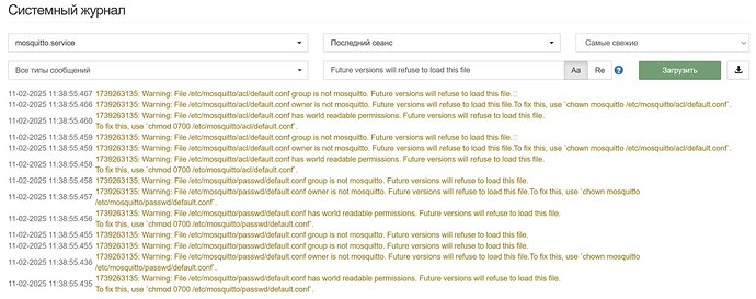

Аналогичная ситуация в логах после последнего обновления:
17-02-2025 02:18:00.427 1739747880: Warning: File /etc/mosquitto/acl/default.conf group is not mosquitto. Future versions will refuse to load this file.
17-02-2025 02:18:00.426 1739747880: Warning: File /etc/mosquitto/acl/default.conf owner is not mosquitto. Future versions will refuse to load this file.To fix this, use chown mosquitto /etc/mosquitto/acl/default.conf.
17-02-2025 02:18:00.425 1739747880: Warning: File /etc/mosquitto/acl/default.conf has world readable permissions. Future versions will refuse to load this file.
To fix this, use chmod 0700 /etc/mosquitto/acl/default.conf.
17-02-2025 02:18:00.413 1739747880: Warning: File /etc/mosquitto/acl/default.conf group is not mosquitto. Future versions will refuse to load this file.
17-02-2025 02:18:00.412 1739747880: Warning: File /etc/mosquitto/acl/default.conf owner is not mosquitto. Future versions will refuse to load this file.To fix this, use chown mosquitto /etc/mosquitto/acl/default.conf.
17-02-2025 02:18:00.412 1739747880: Warning: File /etc/mosquitto/acl/default.conf has world readable permissions. Future versions will refuse to load this file.
17-02-2025 02:18:00.409 1739747880: Warning: File /etc/mosquitto/passwd/default.conf group is not mosquitto. Future versions will refuse to load this file.
17-02-2025 02:18:00.408 1739747880: Warning: File /etc/mosquitto/passwd/default.conf owner is not mosquitto. Future versions will refuse to load this file.To fix this, use chown mosquitto /etc/mosquitto/passwd/default.conf.
17-02-2025 02:18:00.408 1739747880: Warning: File /etc/mosquitto/passwd/default.conf has world readable permissions. Future versions will refuse to load this file.
To fix this, use chmod 0700 /etc/mosquitto/passwd/default.conf.
17-02-2025 02:18:00.407 1739747880: Warning: File /etc/mosquitto/passwd/default.conf group is not mosquitto. Future versions will refuse to load this file.
17-02-2025 02:18:00.407 1739747880: Warning: File /etc/mosquitto/passwd/default.conf owner is not mosquitto. Future versions will refuse to load this file.To fix this, use chown mosquitto /etc/mosquitto/passwd/default.conf.
17-02-2025 02:18:00.406 1739747880: Warning: File /etc/mosquitto/passwd/default.conf has world readable permissions. Future versions will refuse to load this file.
17-02-2025 02:18:00.399 1739747880: Config loaded from /etc/mosquitto/mosquitto.conf.

Никаких манипуляций не производилось!!! Файл всегда был по умолчанию. Смысл в том что сервис mosquitto запускается и работает! Эти ошибки вылезают при запуске
У меня нет ошибок с веб интерфейсом)), ошибки в логах при запуске

Есть какие-то идеи почему так произошло? И как убрать ошибки при загрузке?
