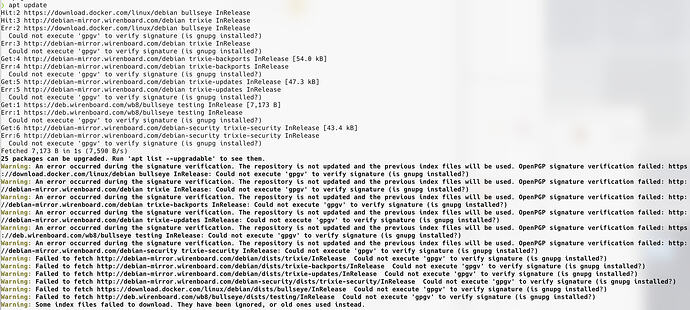

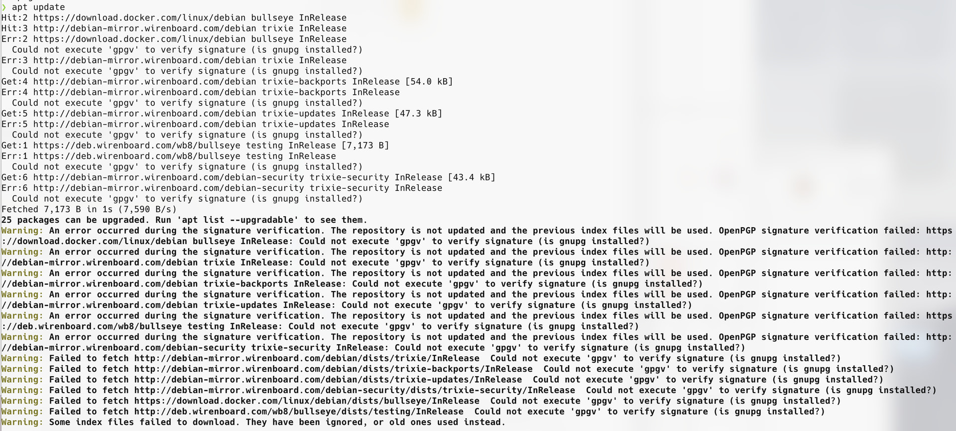

12:30:41 W: Target Translations (main/i18n/Translation-en) is configured multiple times in /etc/apt/sources.list.d/000wb-trixie-upgrade.list:1 and /etc/apt/sources.list.d/debian-upstream.sources:1
12:30:41 W: Target Packages (main/binary-arm64/Packages) is configured multiple times in /etc/apt/sources.list.d/000wb-trixie-upgrade.list:2 and /etc/apt/sources.list.d/debian-upstream.sources:3
12:30:41 W: Target Packages (main/binary-armhf/Packages) is configured multiple times in /etc/apt/sources.list.d/000wb-trixie-upgrade.list:2 and /etc/apt/sources.list.d/debian-upstream.sources:3
12:30:41 W: Target Packages (main/binary-all/Packages) is configured multiple times in /etc/apt/sources.list.d/000wb-trixie-upgrade.list:2 and /etc/apt/sources.list.d/debian-upstream.sources:3
12:30:41 W: Target Translations (main/i18n/Translation-en) is configured multiple times in /etc/apt/sources.list.d/000wb-trixie-upgrade.list:2 and /etc/apt/sources.list.d/debian-upstream.sources:3
12:30:41 W: Target Packages (main/binary-arm64/Packages) is configured multiple times in /etc/apt/sources.list.d/000wb-trixie-upgrade.list:3 and /etc/apt/sources.list.d/debian-upstream.sources:4
12:30:41 W: Target Packages (main/binary-armhf/Packages) is configured multiple times in /etc/apt/sources.list.d/000wb-trixie-upgrade.list:3 and /etc/apt/sources.list.d/debian-upstream.sources:4
12:30:41 W: Target Packages (main/binary-all/Packages) is configured multiple times in /etc/apt/sources.list.d/000wb-trixie-upgrade.list:3 and /etc/apt/sources.list.d/debian-upstream.sources:4
12:30:41 W: Target Translations (main/i18n/Translation-en) is configured multiple times in /etc/apt/sources.list.d/000wb-trixie-upgrade.list:3 and /etc/apt/sources.list.d/debian-upstream.sources:4

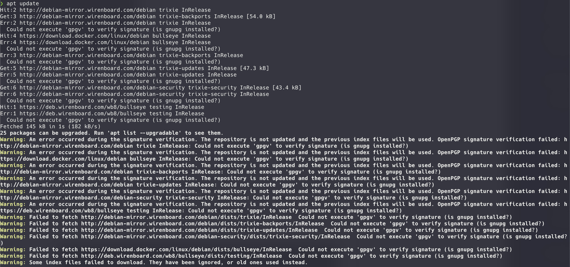

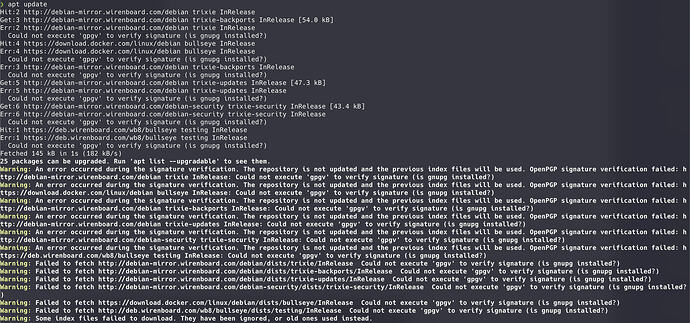

12:30:42 Get:2 https://download.docker.com/linux/debian bullseye InRelease [43.0 kB]
12:30:42 Err:2 https://download.docker.com/linux/debian bullseye InRelease
12:30:42   Could not execute 'gpgv' to verify signature (is gnupg installed?)
12:30:42 Get:1 https://deb.wirenboard.com/wb8/trixie testing InRelease [7,170 B]
12:30:42 Err:1 https://deb.wirenboard.com/wb8/trixie testing InRelease
12:30:42 Get:3 http://debian-mirror.wirenboard.com/debian trixie InRelease [140 kB]
12:30:42 Err:3 http://debian-mirror.wirenboard.com/debian trixie InRelease
12:30:42 Get:4 http://debian-mirror.wirenboard.com/debian trixie-updates InRelease [47.3 kB]
12:30:42 Err:4 http://debian-mirror.wirenboard.com/debian trixie-updates InRelease
12:30:42 Get:5 http://debian-mirror.wirenboard.com/debian-security trixie-security InRelease [43.4 kB]
12:30:42 Err:5 http://debian-mirror.wirenboard.com/debian-security trixie-security InRelease
12:30:42 Get:6 http://debian-mirror.wirenboard.com/debian trixie-backports InRelease [54.0 kB]
12:30:42 Err:6 http://debian-mirror.wirenboard.com/debian trixie-backports InRelease
12:30:43 Reading package lists...
12:30:43 W: OpenPGP signature verification failed: https://download.docker.com/linux/debian bullseye InRelease: Could not execute 'gpgv' to verify signature (is gnupg installed?)
12:30:43 E: The repository 'https://download.docker.com/linux/debian bullseye InRelease' is not signed.
12:30:43 W: OpenPGP signature verification failed: https://deb.wirenboard.com/wb8/trixie testing InRelease: Could not execute 'gpgv' to verify signature (is gnupg installed?)
12:30:43 E: The repository 'http://deb.wirenboard.com/wb8/trixie testing InRelease' is not signed.
12:30:43 W: OpenPGP signature verification failed: http://debian-mirror.wirenboard.com/debian trixie InRelease: Could not execute 'gpgv' to verify signature (is gnupg installed?)
12:30:43 E: The repository 'http://debian-mirror.wirenboard.com/debian trixie InRelease' is not signed.
12:30:43 W: OpenPGP signature verification failed: http://debian-mirror.wirenboard.com/debian trixie-updates InRelease: Could not execute 'gpgv' to verify signature (is gnupg installed?)
12:30:43 E: The repository 'http://debian-mirror.wirenboard.com/debian trixie-updates InRelease' is not signed.
12:30:43 W: OpenPGP signature verification failed: http://debian-mirror.wirenboard.com/debian-security trixie-security InRelease: Could not execute 'gpgv' to verify signature (is gnupg installed?)
12:30:43 E: The repository 'http://debian-mirror.wirenboard.com/debian-security trixie-security InRelease' is not signed.
12:30:43 W: OpenPGP signature verification failed: http://debian-mirror.wirenboard.com/debian trixie-backports InRelease: Could not execute 'gpgv' to verify signature (is gnupg installed?)
12:30:43 E: The repository 'http://debian-mirror.wirenboard.com/debian trixie-backports InRelease' is not signed.
12:30:43 W: Target Packages (main/binary-arm64/Packages) is configured multiple times in /etc/apt/sources.list.d/000wb-trixie-upgrade.list:1 and /etc/apt/sources.list.d/debian-upstream.sources:1
12:30:43 W: Target Packages (main/binary-armhf/Packages) is configured multiple times in /etc/apt/sources.list.d/000wb-trixie-upgrade.list:1 and /etc/apt/sources.list.d/debian-upstream.sources:1
12:30:43 W: Target Packages (main/binary-all/Packages) is configured multiple times in /etc/apt/sources.list.d/000wb-trixie-upgrade.list:1 and /etc/apt/sources.list.d/debian-upstream.sources:1
12:30:43 W: Target Translations (main/i18n/Translation-en_US) is configured multiple times in /etc/apt/sources.list.d/000wb-trixie-upgrade.list:1 and /etc/apt/sources.list.d/debian-upstream.sources:1
12:30:43 W: Target Translations (main/i18n/Translation-en) is configured multiple times in /etc/apt/sources.list.d/000wb-trixie-upgrade.list:1 and /etc/apt/sources.list.d/debian-upstream.sources:1
12:30:43 W: Target Packages (main/binary-arm64/Packages) is configured multiple times in /etc/apt/sources.list.d/000wb-trixie-upgrade.list:2 and /etc/apt/sources.list.d/debian-upstream.sources:3
12:30:43 W: Target Packages (main/binary-armhf/Packages) is configured multiple times in /etc/apt/sources.list.d/000wb-trixie-upgrade.list:2 and /etc/apt/sources.list.d/debian-upstream.sources:3
12:30:43 W: Target Packages (main/binary-all/Packages) is configured multiple times in /etc/apt/sources.list.d/000wb-trixie-upgrade.list:2 and /etc/apt/sources.list.d/debian-upstream.sources:3
12:30:43 W: Target Translations (main/i18n/Translation-en_US) is configured multiple times in /etc/apt/sources.list.d/000wb-trixie-upgrade.list:2 and /etc/apt/sources.list.d/debian-upstream.sources:3
12:30:43 W: Target Translations (main/i18n/Translation-en) is configured multiple times in /etc/apt/sources.list.d/000wb-trixie-upgrade.list:2 and /etc/apt/sources.list.d/debian-upstream.sources:3
12:30:43 W: Target Packages (main/binary-arm64/Packages) is configured multiple times in /etc/apt/sources.list.d/000wb-trixie-upgrade.list:3 and /etc/apt/sources.list.d/debian-upstream.sources:4
12:30:43 W: Target Packages (main/binary-armhf/Packages) is configured multiple times in /etc/apt/sources.list.d/000wb-trixie-upgrade.list:3 and /etc/apt/sources.list.d/debian-upstream.sources:4
12:30:43 W: Target Packages (main/binary-all/Packages) is configured multiple times in /etc/apt/sources.list.d/000wb-trixie-upgrade.list:3 and /etc/apt/sources.list.d/debian-upstream.sources:4
12:30:43 W: Target Translations (main/i18n/Translation-en_US) is configured multiple times in /etc/apt/sources.list.d/000wb-trixie-upgrade.list:3 and /etc/apt/sources.list.d/debian-upstream.sources:4
12:30:43 W: Target Translations (main/i18n/Translation-en) is configured multiple times in /etc/apt/sources.list.d/000wb-trixie-upgrade.list:3 and /etc/apt/sources.list.d/debian-upstream.sources:4
12:30:43 Unholding packages ('wb-update-manager', 'wb-release-info')
12:30:43 Canceled hold on wb-update-manager.
12:30:43 Canceled hold on wb-release-info.
12:30:43 Cleaning up temp apt configs for trixie transition
12:30:43 Restoring original system state
12:30:43 Generating /etc/apt/sources.list.d/wirenboard.list for SystemState(suite='testing', target='wb8/bullseye', repo_prefix='', consistent=True)
12:30:43 Generating /etc/apt/preferences.d/20wb-release for SystemState(suite='testing', target='wb8/bullseye', repo_prefix='', consistent=True)
12:30:43 Cleaning up apt cache (to make manual apt calls safe from now)
12:30:43
The subprocess ('apt-get', '-q', 'update', '-o', 'Dpkg::Options::=--force-confdef', '-o', 'Dpkg::Options::=--force-confold', '--allow-downgrades') has failed with status 100
12:30:43 Try running wb-release --update-debian-release again to continue transition

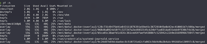

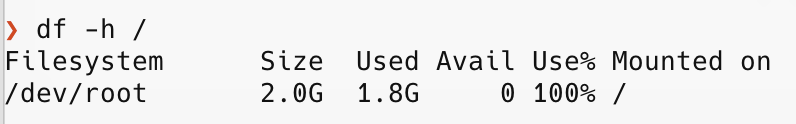

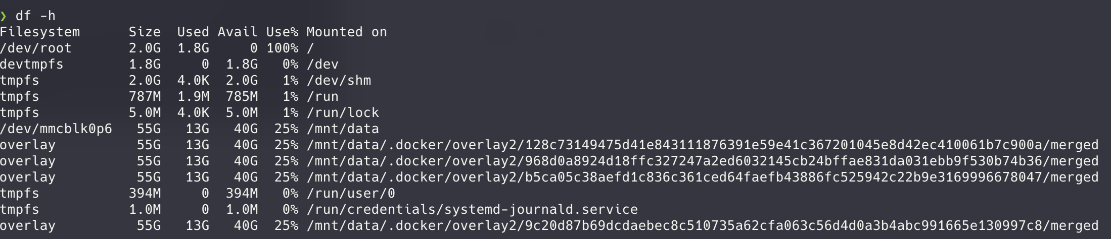

❯ df -h / /root
Filesystem      Size  Used Avail Use% Mounted on
/dev/root       2.0G  1.9G     0 100% /
/dev/mmcblk0p6   55G   12G   41G  23% /mnt/data
Спасибо, теперь видно две проблемы:
  • Корневая файловая система / заполнена на 100%, доступного места нет. При этом /root находится на другом разделе: свободные 41 Гбайт там не устраняют нехватку места в /, где устанавливаются системные пакеты.
  • Переход не завершён: /etc/os-release уже показывает Trixie, а настройки релиза Wiren Board остались на Bullseye. В журнале видно, что обновление остановилось из-за невозможности запустить gpgv для проверки подписей. Связь этой ошибки с заполнением / пока не подтверждена.
Предупреждения о повторяющихся источниках — отдельный вопрос; в приведённом фрагменте выполнение останавливает именно ошибка проверки подписей.
Пока не повторяйте обновление и не отключайте проверку подписей. Сначала пришлите результаты двух проверок:
  1. Что занимает место в корневой файловой системе — команда не заходит в другие разделы:

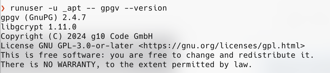

  2. Состояние пакетов и доступность проверки подписей:
    dpkg --audit
    command -v gpgv
    gpgv --version
По этим результатам можно будет выбрать, что безопасно освободить, и уточнить причину ошибки gpgv. В инструкции Wb-2609 указан запас места в /root, но в вашем случае нужно отдельно разобраться с заполненным /.

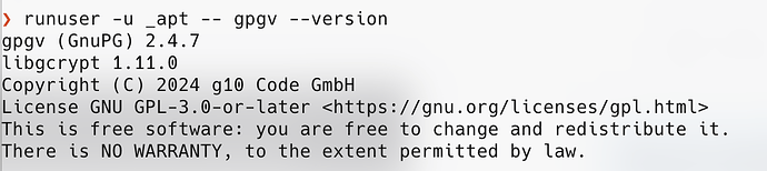

command -v gpgv
ls -l /usr/bin/gpgv
gpgv --version | head -2
По PATH найдём каталог, из-за которого падает настройка пакетов, по du увидим, что занимает место на корне.

/usr/bin/gpgv
-rwxr-xr-x 1 root root 594168 Jul 13 10:28 /usr/bin/gpgv
gpgv (GnuPG) 2.4.7
libgcrypt 1.11.0

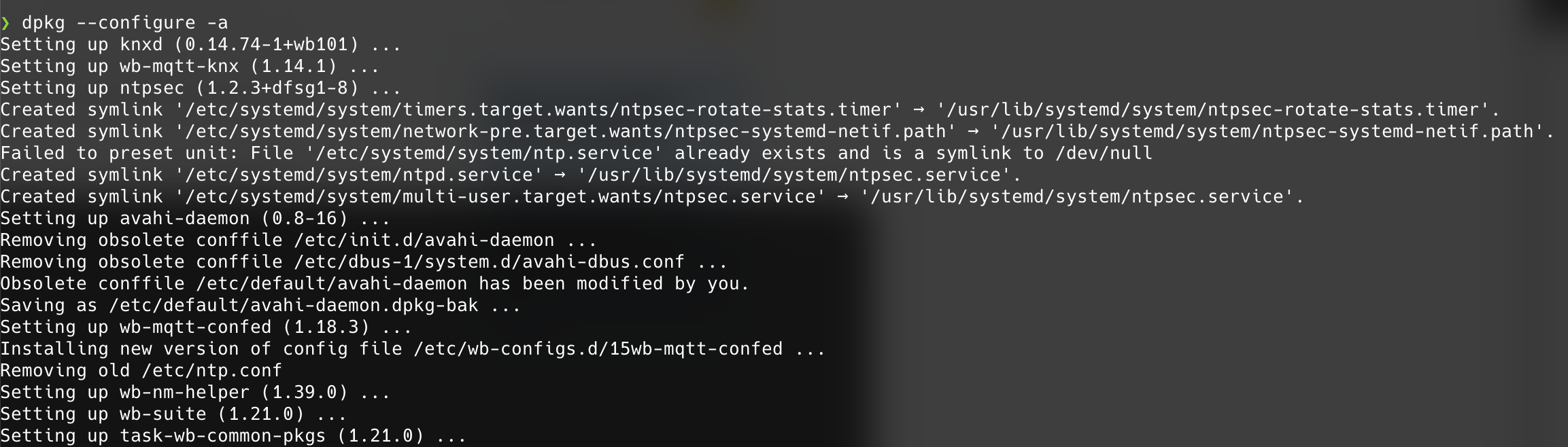

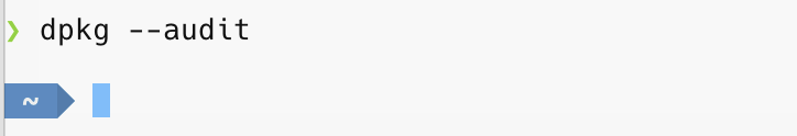

Причина найдена: у каталога /usr/bin права drwxrwxrwx (777), поэтому adduser при настройке ntpsec, knxd и avahi-daemon отказывается работать с «Insecure directory in $ENV{PATH}». Должно быть drwxr-xr-x (755).
Выполните по SSH:
chmod 755 /usr/bin
ls -ld /usr/bin
dpkg --configure -a

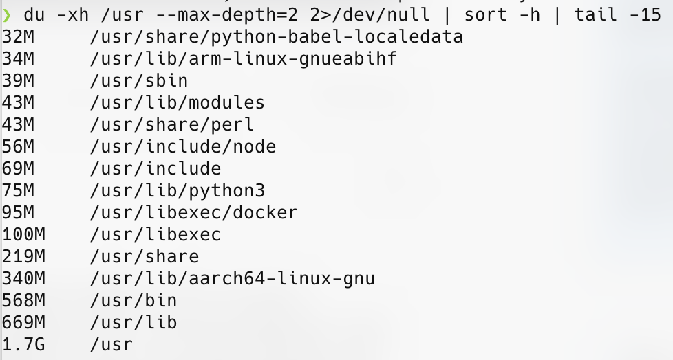

Пришлите вывод ls -ld /usr/bin и dpkg --configure -a. Если команда упадёт или покажет «No space left on device», пришлите ещё:
du -xh /usr --max-depth=2 2>/dev/null | sort -h | tail -15
wb-release и apt upgrade пока не запускайте.
Пакеты настроены, ошибок нет. Выполните по SSH и пришлите вывод:
df -h /
apt update
apt upgrade -y
dpkg --audit
wb-release пока не запускайте.
Пакеты настроены, /usr/bin исправлен. Осталась другая ошибка: apt не может запустить gpgv, утилиту проверки подписей репозиториев, хотя от root она работает. apt запускает её от пользователя _apt. Плюсом идет заполненность корневого раздела, эту проблему тоже надо устранить.
Чтобы проверить, запускается ли gpgv от _apt, выполните:
runuser -u _apt -- gpgv --version
Чтобы увидеть, что занимает место на корневом разделе, выполните:

Дайте, пожалуйста, вывод следующих команд:
df -h /
dpkg --audit
apt update
Пока без apt upgrade и повторного запуска миграции.
Странно, до начала обновления вроде не был занят на 100%
Еще странно что 1.8G Used это 100% от 2.0G Size )
