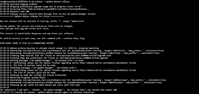

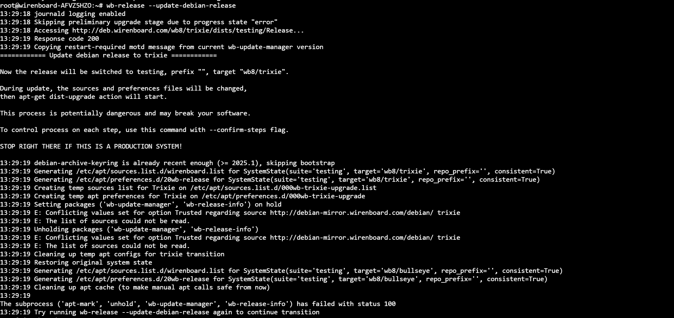

Обновление не проходит.
Покажите полный вывод текстом пожалуйста.
Last login: Wed Jul 22 14:57:20 2026 from 127.0.0.1
root@wirenboard-AFVZ5HZO:~# wb-release --update-debian-release
15:13:19 journald logging enabled
15:13:19 Skipping preliminary upgrade stage due to progress state “error”
15:13:19 Accessing http://deb.wirenboard.com/wb8/trixie/dists/testing/Release
15:13:19 Response code 200
15:13:19 Copying restart-required motd message from current wb-update-manager version
============ Update debian release to trixie ============
Now the release will be switched to testing, prefix “”, target “wb8/trixie”.
During update, the sources and preferences files will be changed,
then apt-get dist-upgrade action will start.
This process is potentially dangerous and may break your software.
To control process on each step, use this command with --confirm-steps flag.
STOP RIGHT THERE IF THIS IS A PRODUCTION SYSTEM!
15:13:19 debian-archive-keyring is already recent enough (>= 2025.1), skipping bootstrap
15:13:19 Generating /etc/apt/sources.list.d/wirenboard.list for SystemState(suite=‘testing’, target=‘wb8/trixie’, repo_prefix=‘’, consistent=True)
15:13:19 Generating /etc/apt/preferences.d/20wb-release for SystemState(suite=‘testing’, target=‘wb8/trixie’, repo_prefix=‘’, consistent=True)
15:13:19 Creating temp sources list for Trixie on /etc/apt/sources.list.d/000wb-trixie-upgrade.list
15:13:19 Creating temp apt preferences for Trixie on /etc/apt/preferences.d/000wb-trixie-upgrade
15:13:19 Setting packages (‘wb-update-manager’, ‘wb-release-info’) on hold
15:13:19 E: Conflicting values set for option Trusted regarding source Index of /debian trixie
15:13:19 E: The list of sources could not be read.
15:13:19 Unholding packages (‘wb-update-manager’, ‘wb-release-info’)
15:13:19 Cleaning up temp apt configs for trixie transition
15:13:19 Restoring original system state
15:13:19 Generating /etc/apt/sources.list.d/wirenboard.list for SystemState(suite=‘testing’, target=‘wb8/bullseye’, repo_prefix=‘’, consistent=True)
15:13:19 Generating /etc/apt/preferences.d/20wb-release for SystemState(suite=‘testing’, target=‘wb8/bullseye’, repo_prefix=‘’, consistent=True)
15:13:19 Cleaning up apt cache (to make manual apt calls safe from now)
15:13:19
The subprocess (‘apt-mark’, ‘unhold’, ‘wb-update-manager’, ‘wb-release-info’) has failed with status 100
15:13:19 Try running wb-release --update-debian-release again to continue transition
Index of /debian trixie судя по логу описан в конфигурации apt дважды.
