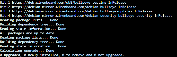

Сломалась интеграция с алисой, решил, что дело в обновлении модулей, обновил модули до последней версии, ничего не поменялось.

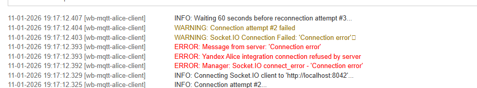

соответственно и сервис интеграции с Яндекс:
Jan 13 19:36:40 wirenboard-AJ4CNJHP python3[3453]: WARNING: Manager: Socket.IO disconnected
Jan 13 19:36:40 wirenboard-AJ4CNJHP python3[3453]: INFO: stop alice device state sender
Jan 13 19:36:40 wirenboard-AJ4CNJHP python3[3453]: INFO: Alice state sender stopped due to disconnect
Jan 13 19:36:40 wirenboard-AJ4CNJHP python3[3453]: INFO: send loop finished
Jan 13 19:36:42 wirenboard-AJ4CNJHP python3[3453]: ERROR: Manager: Socket.IO connect_error - 'Connection error'
Jan 13 19:36:42 wirenboard-AJ4CNJHP python3[3453]: ERROR: Yandex Alice integration connection refused by server
Jan 13 19:36:42 wirenboard-AJ4CNJHP python3[3453]: ERROR: Message from server: 'Connection error'
Jan 13 19:36:47 wirenboard-AJ4CNJHP python3[3453]: ERROR: Manager: Socket.IO connect_error - 'Connection error'
Jan 13 19:36:47 wirenboard-AJ4CNJHP python3[3453]: ERROR: Yandex Alice integration connection refused by server
Jan 13 19:36:47 wirenboard-AJ4CNJHP python3[3453]: ERROR: Message from server: 'Connection error'
Jan 13 19:36:55 wirenboard-AJ4CNJHP python3[3453]: ERROR: Manager: Socket.IO connect_error - 'Connection error'
Jan 13 19:36:55 wirenboard-AJ4CNJHP python3[3453]: ERROR: Yandex Alice integration connection refused by server
Jan 13 19:36:55 wirenboard-AJ4CNJHP python3[3453]: ERROR: Message from server: 'Connection error'
Jan 13 19:37:11 wirenboard-AJ4CNJHP python3[3453]: INFO: Manager: Success connected to Socket.IO server, namespace='/' ready (sid='S-pgTT11olODPI6hAABF')
Jan 13 19:37:11 wirenboard-AJ4CNJHP python3[3453]: INFO: start alice device state sender
Jan 13 19:37:11 wirenboard-AJ4CNJHP python3[3453]: INFO: Alice state sender started after connect
Jan 13 19:47:44 wirenboard-AJ4CNJHP python3[3453]: WARNING: Manager: Socket.IO disconnected
Jan 13 19:47:44 wirenboard-AJ4CNJHP python3[3453]: INFO: stop alice device state sender
Jan 13 19:47:44 wirenboard-AJ4CNJHP python3[3453]: INFO: Alice state sender stopped due to disconnect
Jan 13 19:47:44 wirenboard-AJ4CNJHP python3[3453]: INFO: send loop finished
Проверьте пожалуйста что возвращает настроенный DNS при запросе имен серверов.
